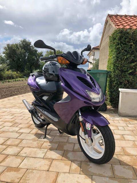

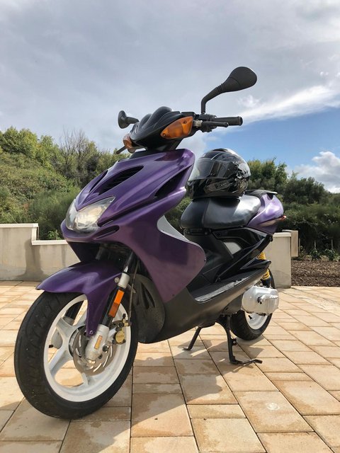

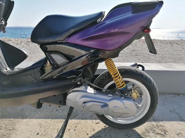

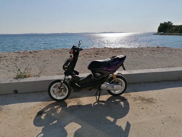

There were a lot of little things that had to be done and unfortunately I did not take pictures of everything which I kind of regret now... I spents a lot of hours taking care of all of the little things but all in all everything got sorted out. After all of the work I started to break in the new cylinder and piston and I started to get all of the small tuning sorted out.
Post by nikola11 on Oct 23, 2020 5:45:03 GMT -5
For the first few hundred kilometers I was using a Dellorto 21mm carb but I felt that it was unnecessary because I am only running a base cylinder kit. I also wanted to reduce the fuel consumption as this is a daily ridden scoot. I tried using a Dellorto 17.5mm carb and that worked out great. It still needs some fine tuning but I am happy with the results. The last time I measured the top speed it was 99 km/h. I got an averege consumption of 4.5 L/100km or 52 miles to galon. I think there is room for improvement. There is also room for improvement in the cvt area but for now I will enyoj riding it and slowly get all of the little thing buttoned up. Here are some pics of the complete build

nikola11, Nice work with the build. Scooter is looking better in each shot.
Post by nikola11 on Oct 23, 2020 12:35:48 GMT -5
Thank you! It is far from perfect but it is much better than it used to be. And now it is actually rideable and safe!

lovely job mate looks lovely
Post by pinkscoot on Oct 23, 2020 17:11:35 GMT -5
Beautifully done. I like the work with fiberglass.

lovely job mate looks lovely Thanks!
Post by nikola11 on Oct 23, 2020 18:36:50 GMT -5
Beautifully done. I like the work with fiberglass. Thank you! Patching the holes and fixing broken pieces of plastic seemed easiest to do with fiberglass.
