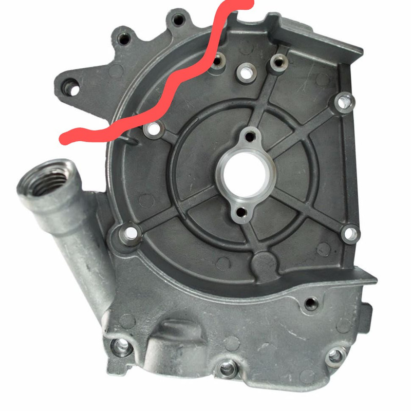

jjlec
Scoot Junior
Posts: 16
Post by jjlec on Oct 31, 2020 13:03:35 GMT -5
 That's roughly where the break is. Totally clean break with a gap. The suspension is connected to some of those holes that is broken off which makes it sketchy to me.

Post by jjlec on Oct 31, 2020 14:21:46 GMT -5
I've never rebuilt that much before. I've done crank oil seals/top end. Stuff like that, how much harder is replacing that half of the case? My other option is maybe finding a cheap parts scooter for $100-150 or so and steal a good engine off it.
Post by GrumpyUnk on Nov 1, 2020 9:16:03 GMT -5
A gasket set, the new part, and then... You have to remove the engine from the scooter. Then the ductwork, the rear wheel, all the fluid, the rotor(generator wheel), the stator, the cylinder & head, and a buncha bolts. You then get to separate the two halves. I think the oil pump and chain, then clean the gasket surface, and put back together. Simplified.
You may find the whole thing in a youtube video. It is hours of work. Lots of gasket cleaning time. You can re-use the piston/rings/cylinder if desired. I am not sure, but think the crankshaft bearing will stay with the crankshaft when the case is removed. If not, a press may be necessary. I have not done this... tom
