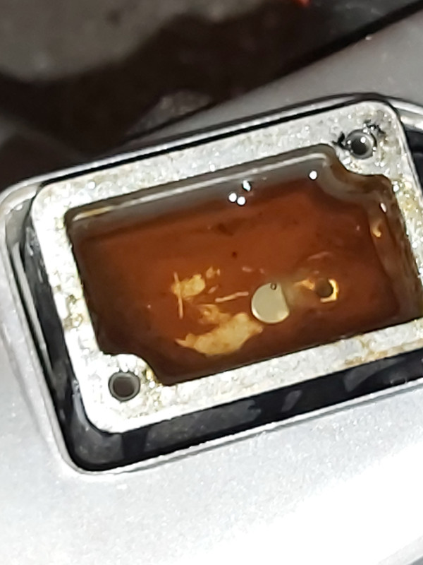

Post by love2ride1111 on Oct 30, 2020 19:40:59 GMT -5
I got pressure and it grabs brake. I will go try see how it is. I propped the bike some more vertical and added fluid to the top. Perhaps it was pulling air in since master cylinder was on angle ., Idk . Here is a pic inside. What is that silver thing in middle ?
Post by aeroxbud on Oct 30, 2020 19:51:01 GMT -5
That brake fluid looks horrible. It should be a clear colour. It at least needs changing.

Post by love2ride1111 on Oct 30, 2020 20:03:26 GMT -5
That is all brand new. You might see the bottom of cylinder . What is the silver disk in the center ?

Post by aeroxbud on Oct 30, 2020 20:30:11 GMT -5
That is all brand new. You might see the bottom of cylinder . What is the silver disk in the center ? Why is it a funny orange colour? I think the disc in the middle is to stop the diaphragm from sitting in the bottom. And blocking the passage way.

Post by love2ride1111 on Oct 30, 2020 21:16:25 GMT -5
Idk , I do not see colors very well but it was from a brand new bottle of brake fluid .

Post by aeroxbud on Oct 30, 2020 21:22:30 GMT -5
If the fluid was low, you may of got air in the system. As you have a new bottle of fluid. Just bleed the whole system through. Can't be too careful with brakes.
