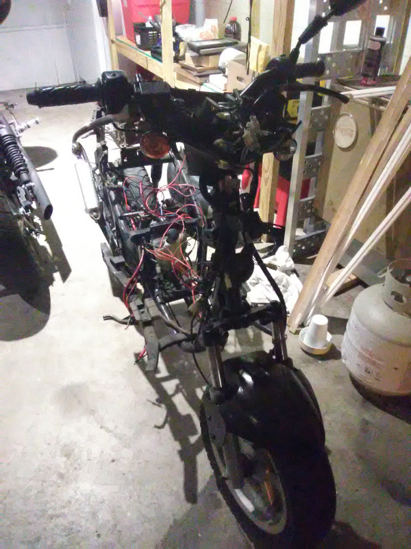

Picked up this very beat up Yamati RX8i today. It's pretty beat to hell cosmetically, but the frame seems sound. Horizontal chinese minarelli. According previous owner it was 2nd engine. They gave me the original as well, which I'm sure is seized, but hey, how often do people just give you an engine? So that will be a fun project as well. I got the beat up plastics off. Man, there's been a lot of wire splicing. Previous has wired speakers and an old school car cigarette lighter into it. 😵 Anyway, should be a fun project through the winter. Will keep updates posted. Finally got all the plastics off. Lots of wire splices in the main harness.

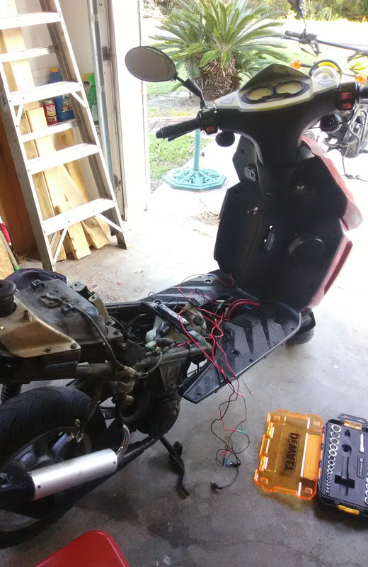

Same dash/upper plastics as my Keeway F-act

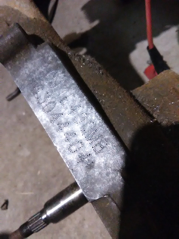

Check your engine code. Could be a 1E40FM, which is basically a set of 90cc cases filled with 49cc parts (slightly different than the standard 49cc stuff). If that's the case, you should be able to get a stroker crank and a 52-54mm bore and build a ~100cc pretty easily.

Nice project. Should be good once you sort out the spaghetti.

Same dash/upper plastics as my Keeway F-act Yessir! Looked exactly like your photo. It was completely screwed. Had been sitting in the sun for a while and with all the weird wiring, I didn't have much hope.

Check your engine code. Could be a 1E40FM, which is basically a set of 90cc cases filled with 49cc parts (slightly different than the standard 49cc stuff). If that's the case, you should be able to get a stroker crank and a 52-54mm bore and build a ~100cc pretty easily. That would be a total Bonus! Will check the codes on the engines when I get home.

Nice project. Should be good once you sort out the spaghetti. Truth. Homeboy was up to some weird business when he started splicing into harness. This thing had an old school cigarette lighter, household usb charger, a computer speaker, and a car stereo wired to it! 😵. Alligator clips and heat shrink as well as crimp on couplers all over the place. I think I gotta start from scratch. Just too much weirdness here. Lol.

Same dash/upper plastics as my Keeway F-act Yessir! Looked exactly like your photo. It was completely screwed. Had been sitting in the sun for a while and with all the weird wiring, I didn't have much hope. I know my Speedo I grafted into my factory dash seems to work ok. With the exception of the damn clock and that irks me.

Check your engine code. Could be a 1E40FM, which is basically a set of 90cc cases filled with 49cc parts (slightly different than the standard 49cc stuff). If that's the case, you should be able to get a stroker crank and a 52-54mm bore and build a ~100cc pretty easily. Sadly I did not win the 1E40FM scratch off lottery. Lol! 😂 Still, it was a free engine, so I will call that a win any day. Am hopeful I can get her sorted out. Got the PB Blaster sitting in the cylinder which seems to be locked at top dead center. I'm a keep hitting it with that stuff and slowly work it to see if I can get it free. For now, I'm a let it soak.

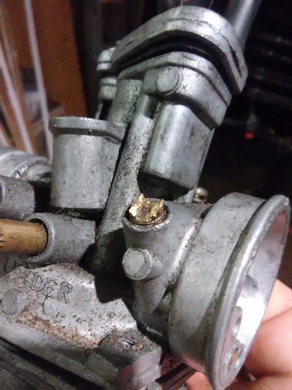

So I have a couple questions... What was this guy on when he did this? Did he use a drill on this thing? Poor air screw is completely mangled as is every other screw on this carb.
Post by aeroxbud on Nov 11, 2020 20:22:43 GMT -5
Looks like the only screw driver he had, was hammer shaped.
Post by jloi on Nov 12, 2020 8:24:13 GMT -5
he needed more leverage- so he widened the slot - for a larger screwdriver. -- of course . that was after the needlenose vice grips didn't work .
