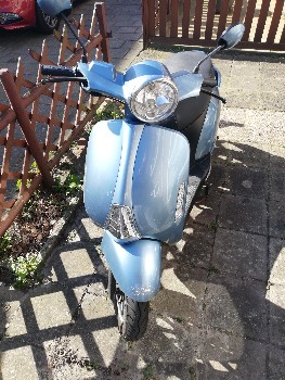

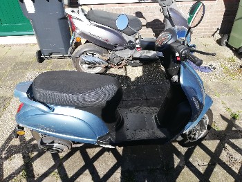

Post by lovetorepairmybrain on Nov 18, 2020 18:46:51 GMT -5
Post by aeroxbud on Nov 18, 2020 19:00:09 GMT -5
I have not once heard of an engine block cracking because synthetic oil was used. These scooters get seriously abused. Some do thousands of miles without ever having even an oil change. Some are run on cheap car oil. They still run. You have to remember, most of these scooters will end up in third world countries. And he put through far worse conditions than most Americans would put them through.
