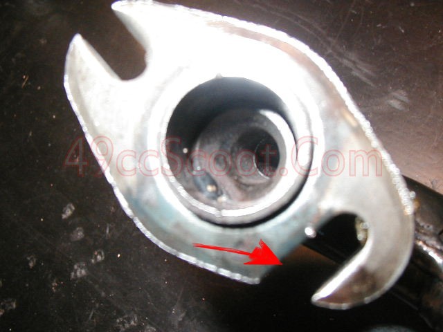

Please mount of the tecnigas and show us how close to the tire it is . Also take a picture of the head of the pipe where it would connect to the cylinder It may just require reslotting with a dremel at the head of the exhaust pipe so it rotates different

Hey it’s Mike and I own a Adly Gta 50 ... The local scooter shop in Florida and racing planet have tried 3 different aftermarket exhausts and no luck on fitting my scooter 🙄 Does anyone know of an aftermarket exhaust that will fit my scooter? Racing planet suggested I go to a store that has them on stock to get a fitment but nobody carries a lot in stock. Really frustrating and scooter shop says I have a unicorn scooter but it’s a minarelli I believe so I dunno... please any suggestions Your Adly bore might be like the CPI bores. Yes it's a minarelli based engine, but from pictures I've seen comparing Chinarelli cylinders to the CPI cylinders, the angle of the exhaust flange on the CPI cylinder is different from the conventional minarelli cylinders.
