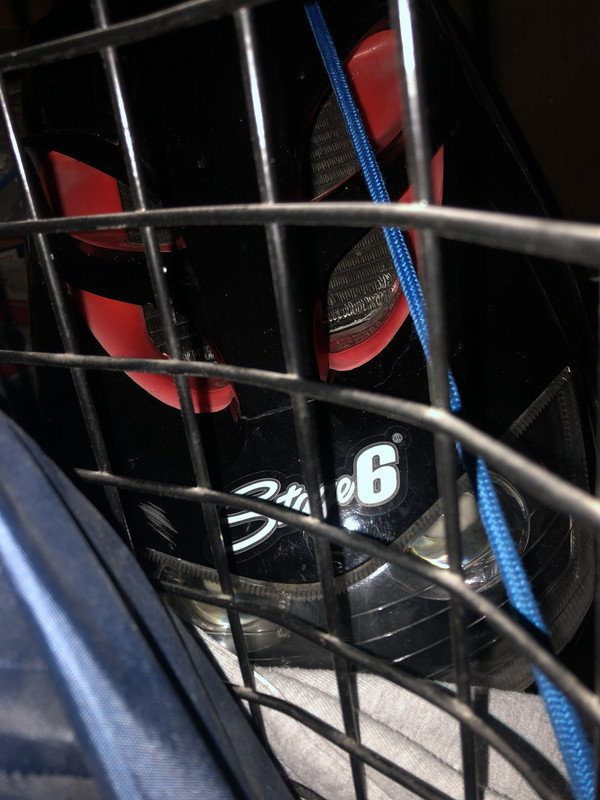

Me and a friend Of mine picked up This 18year old Aprilia last night. £200! we will bring the poor thing back to life
Post by geoffh on Nov 24, 2020 15:35:28 GMT -5
Sweet deal,if it,s got a title you can let it of that cage Geoff
Post by yambw’s on Nov 24, 2020 15:49:15 GMT -5
I thought so too, Geoff. It won’t be caged for long
Post by aeroxbud on Nov 24, 2020 17:04:58 GMT -5
That is a serious bargain. Which engine does it have in it?
Post by yambw’s on Nov 24, 2020 17:18:11 GMT -5
That is a serious bargain. Which engine does it have in it? Isn't it! It has the Morini engine.. I was hoping for the air cooled minarreli but you can still get some parts for the Morini
