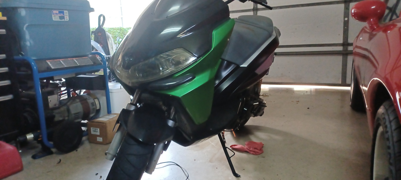

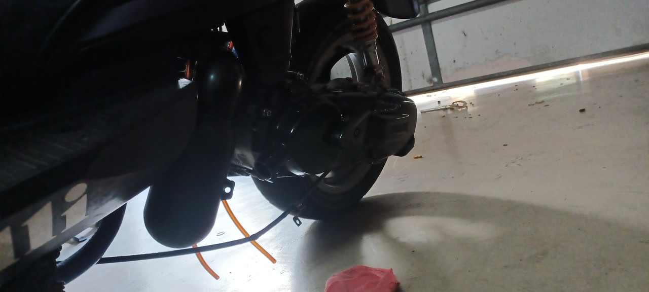

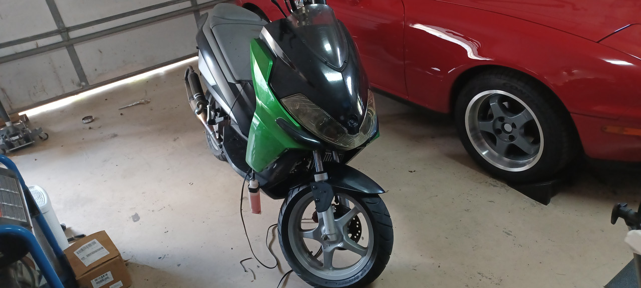

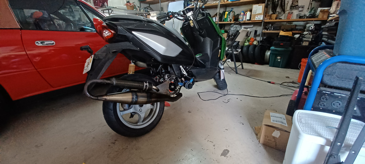

Edit! After realizing I haven't uploaded a single picture of the benelli I'll now fill this portion of my post with it.
Don't mind the right side panels, making adjustments with plastics to have My radiator reservoir in simple to get to location.
And sadly no euro turn signals. I'm a searching for them so for now I just installed turn signals in the black out section
Just a slight edit again, the benelli comes with a flat cover over the front. I got risky and sanded and primed with rustoleum black finish, and I think it's the best thing I've ever spray painted with a factory like look and once polished gave a nice reflection
it may not show it now since it's been sitting for a bit but the scoot has more shine than usual. An waiting for the Kickstart and electric bits was no help.
