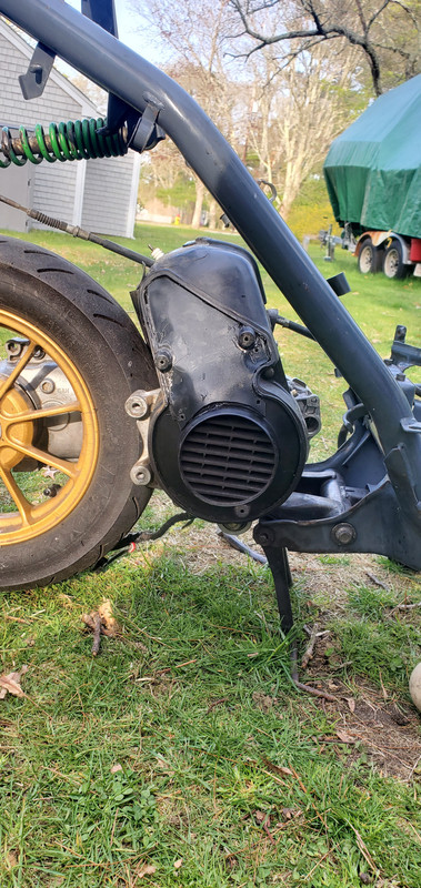

I assembled the motor today. I ended up using two paper base gaskets the some Motoseal to seal up the stacked gaskets. The bike came with a Sunworld PWK 28mm carb. It has a power jet and some ports im not familiar with. I think they are overflow ports but im not sure. Im also not familiar with powerjets either. Im not sure what they are really for, is it just to add more fuel WOT outside of the main jet? Here are those strange ports.  When I cranked over the motor it idles very high. Im not sure if its just a small main jet or I have an airleak. Ill put the pressure tester on it tomorrow to check it. It turns out the motor is also an AF16E and not the AF18E. Normally I wouldnt mind but its a problem in this case. There is no vacuum port on the cases to operate the fuel pump. So to solve the problem I am going to modify the oil pump plug to have a nipple for some vacuum tube. Ill post the results tomorrow.  Yes, those are vents. Man, por15 goes hard. I did some floor pans 20 years ago. Can beat with a hammer won't chip. Anywho, that's a nice ride going to be a good time!

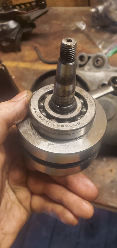

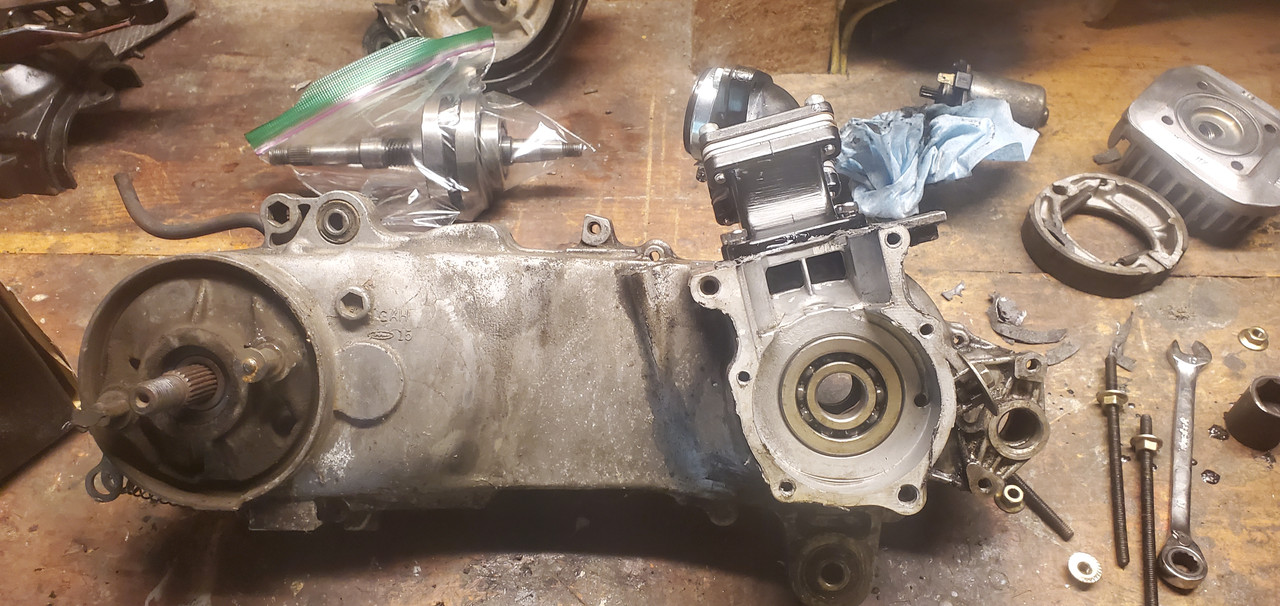

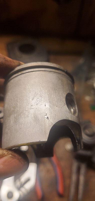

I started up the motor again today and the ticking\clicking noise got worse. I checked my squish and im at 1mm which im sure is safe. The noises concerned me enough that I decided to breakdown the motor and investigate. Here are my observations. The cylinder and piston dont show any major scoring or wear however the hatching on the cylinder walls is gone. Upon closer inspection however I noticed the piston skirt is cracked and slightly chipped. The wrist pin was seriously stuck inside the piston. I needed to use a C clamp and socket to press the wrist pin out of the piston. The wrist pin bearing seemed to be fine. The piston can move around inside the bore. With the piston at TDC I gently tried to move the piston around the bore and it did so freely and without any effort. This was exasperated as the piston moved closer to BDC. The crank isnt a PG crank at all. Its the ScooterTuning mini-stroker crank. Its branded 2AB, I assume thats the company that produces them. It has a stroke of 43.2mm etched on one of its journals. The crank bearings are OEM Honda and in seemingly OK shape. However with the cases already broken down I would rather just spend the money and replace them than roll those dice. With all that in mind here is my current plan. I think the Polini Corsa on this thing is just too far gone. The cracked piston, the piston slap, the stuck wrist pin and poor setup of the motor makes me think this thing was abused. The cases, crank, carb, intake, gears and ignition are all good however. I plan to purchase the 50mm (or similar) bore that is meant for a mini stroker crank. If I really feel the need I could always increase the exhaust duration to get some more juice out of it. Im also going to purchase some fresh bearings and seals. Im already inside the motor I may as well do a complete job and do it right. I like having that peace of mind.
Post by aeroxbud on Oct 25, 2021 16:23:42 GMT -5
Good idea. That piston doesn't look good. And whoever built the motor should of used new bearings. Better to be safe than sorry.
Post by 808ministroke on Oct 27, 2021 2:46:20 GMT -5
So that clicking noise that clicking noise is one that I've gotten several times on a few different bikes Here are some things that caused it for me maybe one of these is the issue of your clicking. 1st off I would check The fan and and make sure the propellers aren't hitting a shroud or a bolt Also could be like the urbandics for your electric starter on the variator side Or could even be that heat shield on your exhaust rattling. After you tore it down the 2nd thought could have been piston slap is that what your determining it was?*¿◇¿☆?
Post by hippo008 on Nov 3, 2021 9:22:05 GMT -5
So that clicking noise that clicking noise is one that I've gotten several times on a few different bikes Here are some things that caused it for me maybe one of these is the issue of your clicking. 1st off I would check The fan and and make sure the propellers aren't hitting a shroud or a bolt Also could be like the urbandics for your electric starter on the variator side Or could even be that heat shield on your exhaust rattling. After you tore it down the 2nd thought could have been piston slap is that what your determining it was?*¿◇¿☆? Im fairly certain it was piston slap. I took the fan shroud, fan and small side cover off and had the same results. Even if it wasnt piston slap the piston it came with was cracked anyways. It would cost about $100 for a new Polini Corsa piston kit or about $130 for a whole new 50mm top end. Even though the Corsa is a great platform id rather save myself the potential headaches and get new parts.

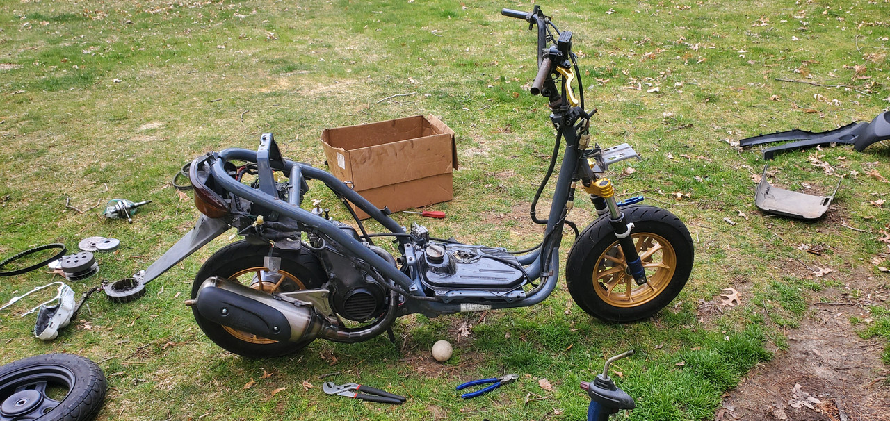

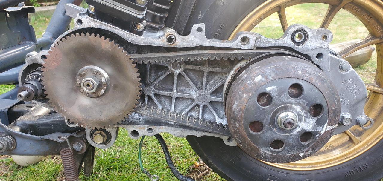

THE TIME HAS COME A gentleman in my area let me know he's importing a couple rare Jog 90s from Japan. You know I'm interested in a Jog 90, so that means it's time to slap together this hunk of junk and get it sold! I have entered full scavenger mode to get this thing completed with as few dollars as possible.  I put in the cheap mini stroker AF16 I just completed in this frame. I want to keep my Baja totally JDM and a filthy AF16 doesn't fit the bill. Plus I got all of the parts on a deep discount! I removed all the nice overrange CVT stuff and slapped in some old stock Honda AF18 CVT to get it rolling. I also put on the greatest most ghetto air shroud this world has ever seen, it's fantastic.   I temporarily have a Polini PWK 24 mounted on this thing. That's way too nice a carb for this bike so I plan on buying the cheapest OKO I can get my grubby fingers on and using that. It started right up and sounds pretty good!
