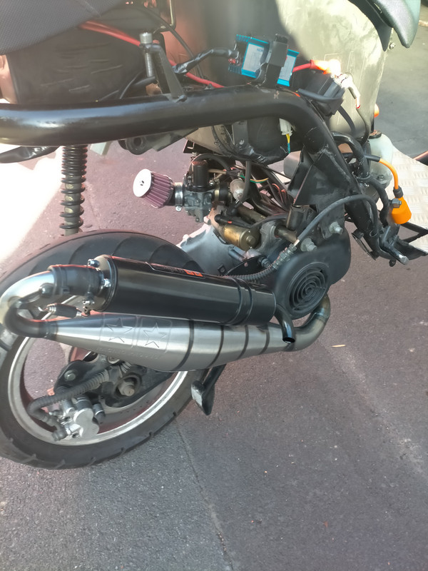

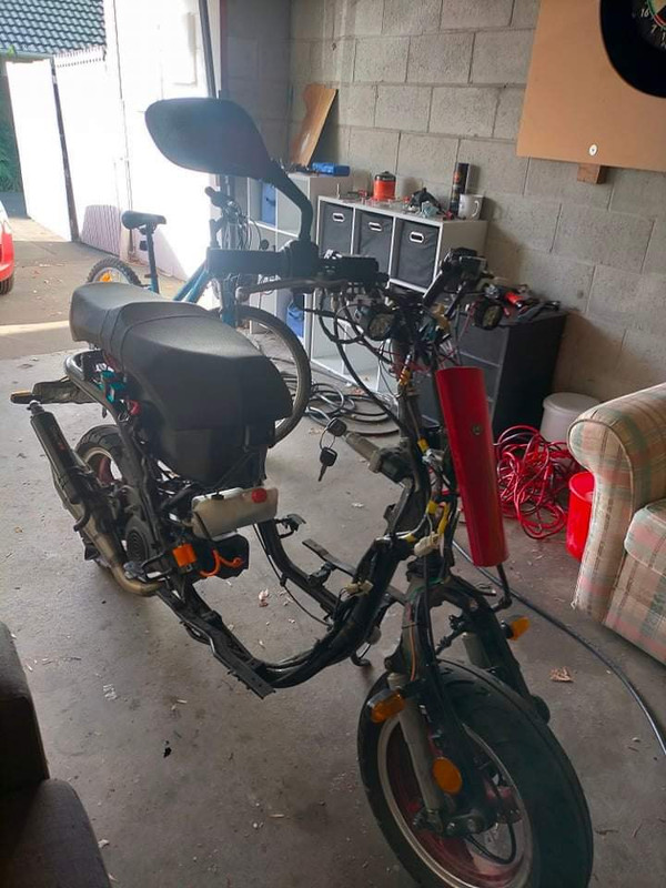

I got this rundown Chinese minarelli a year ago it had lots of wiring issues and it was pretty beaten up. so far its a stage 6 exhaust, lighter clutch, the springs and rollers, pod filter and a 92 jet. Most of the work was in moving things (like the fuel tank) to make it look better at least in my eyes. Its just a 50cc for now. Work in progress.

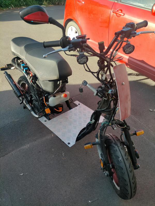

body work over the weekend i will make the front of the foot rest safer soon i dont want to cut my foot off really.

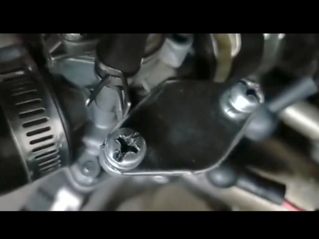

Hey what does anyone think and running the petcock hose to the little hole on the pod filter? (It's in my photos) there is a pre existing hole there from a cover that I took off because I didn't like to look off, might need a little bung or something.

So the Auto choke it's totally stupid and makes it hard to get an even idol with a big jet it just spits unburnt gas and randomly dies and all kinds of stuff so I took it off put the little petcock back in and filled it with solder. Then made a nice little cover with a beer can. All previous mentioned problems solved more responsive riding and definitely worth the effort. Also adds I nice bit of shiny to the carb 😂
