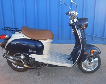

I have 2002 Yamaha Vino 50, mostly stock (muffler restrictor removed) and it goes like a scalded cat. However, the rear shock makes it pogo too much to enjoy top speed. Yamaha doesn't make the shock anymore, its not the same as later models, and no aftermarket options appear available. There are used ones on ebay, but I have little hope that they will perform better than the one I already have. Is there someone who I can send it to who rebuilds cheap little shocks like this? Or, does anyone know how to find a decent new one? Any other thoughts?
(Not mine, but same color, obviously has a nicer muffler, mine is stock)
