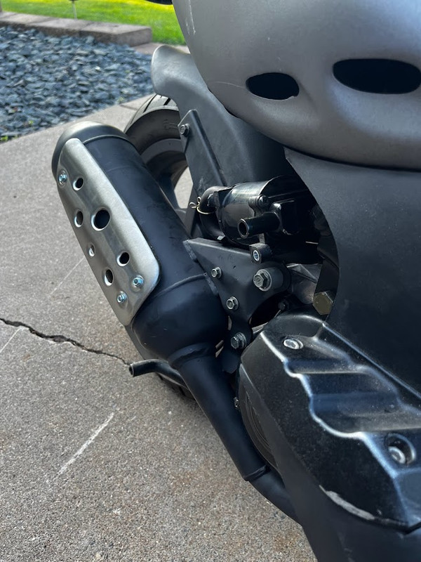

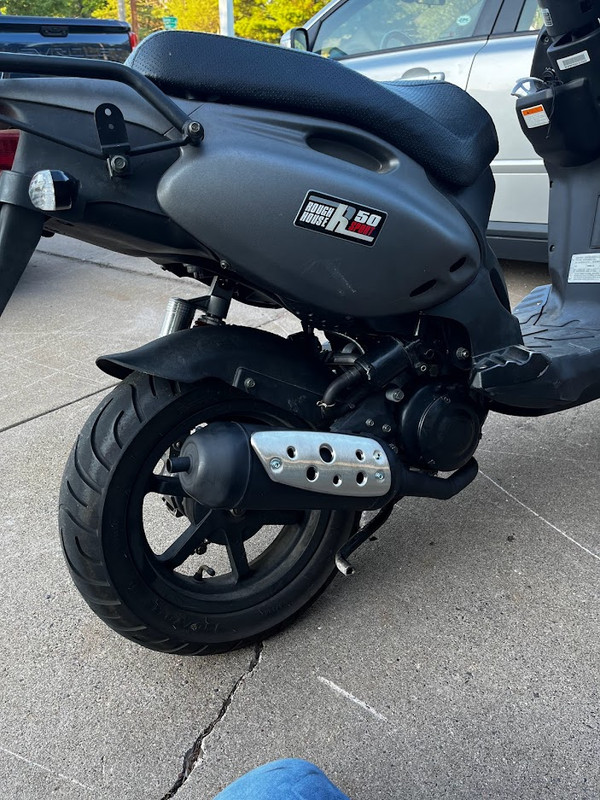

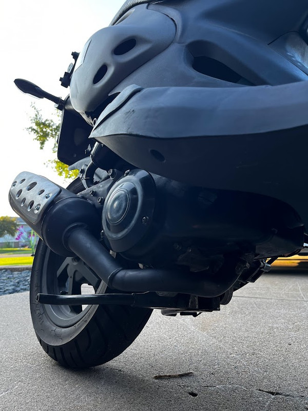

We have not seen that pipe mounted up on a roughhouse Yet Can you take a picture of your pipe mounted up on your scoot from a few different angles . Did you have to shim or bend dremel it to make it fit ?

That is a great pipe that has a wide powerband and good top end for a street pipe . With my zuma setup I had a full gram of leeway for variator weights with plenty of takeoff power and top speed We have not seen that pipe mounted up on a roughhouse Yet Can you take a picture of your pipe mounted up on your scoot from a few different angles . Did you have to shim or bend dremel it to make it fit ? Here's a couple of pics. It fit with no modifications. I was barley able to squeeze 1/4 inch thick rubber washers in-between the exhaust mount flange and the scoot.
Post by Zino on Aug 9, 2022 8:08:47 GMT -5
Looks great I unhooked the pollution control canister and tucked the rest of the tupe under the seat
