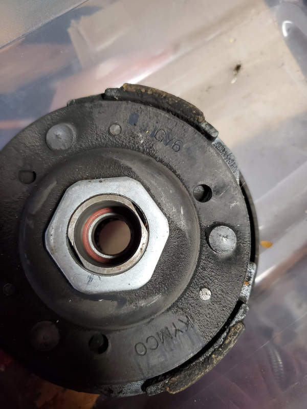

Post by wiscootsin on Jan 2, 2023 12:18:25 GMT -5
oem kymco parts are stamped GY6 so, there is that. This is a clutch from a kymco agility 125
