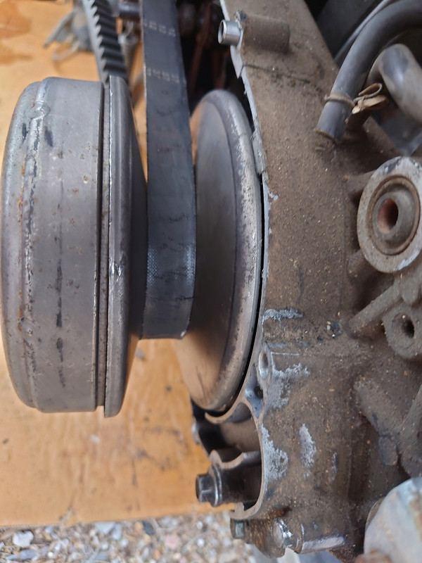

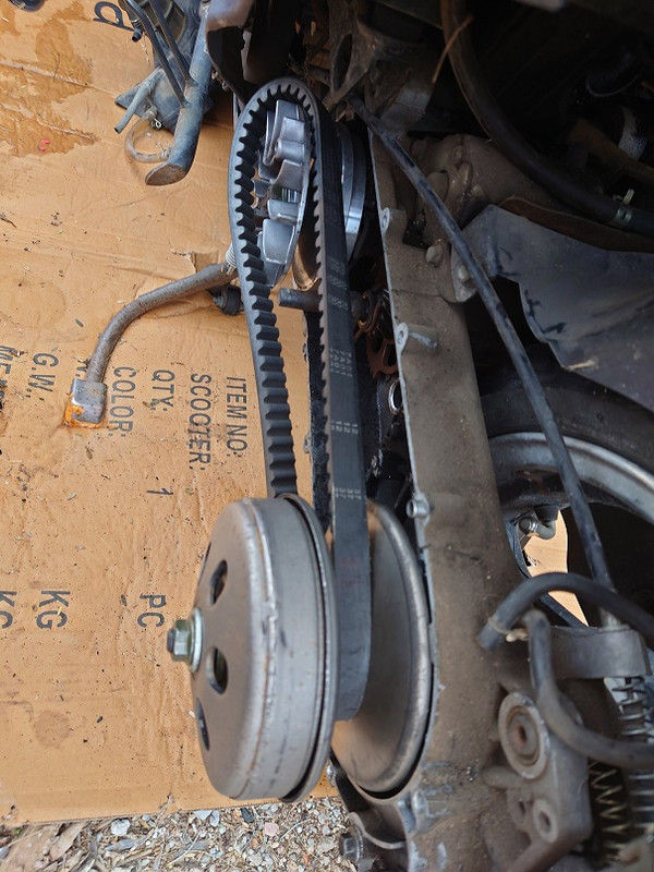

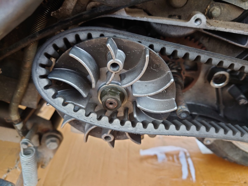

Thanks for your reply. With my recent work schedule I haven't had time to tinker with the scooter for a while, but I was able to run a few tests today. Yes, without the belt attached the scooter runs and revs without issue. The back tire doesn't seem to wiggle but I did notice with rolling the scooter to a different part of my yard where I could work on it, there was a swishing sound coming from the back. I can't really fully test the back tire as with the jack I have and all the weight being in the back, when I jack it up the front end lifts up instead. Something I did notice when trying to get the belt back onto the clutch, per videos I've seen of other scooters there's supposed to be slack in the belt when the clutch is fully open, however in my case even with the clutch open and the belt as far in as it could go I wasn't able to slide the other end of the belt over the motor. At this point I'm thinking it could either be a belt issue or something with the sprockets and bearings behind the clutch that might be out of whack. I've included some photos showing the lack of slack in the belt.

Wow,how many miles are on the belt ?? That is not supposed to be that much room on the belt. Never seen a belt be able to actually slide over the variator before
