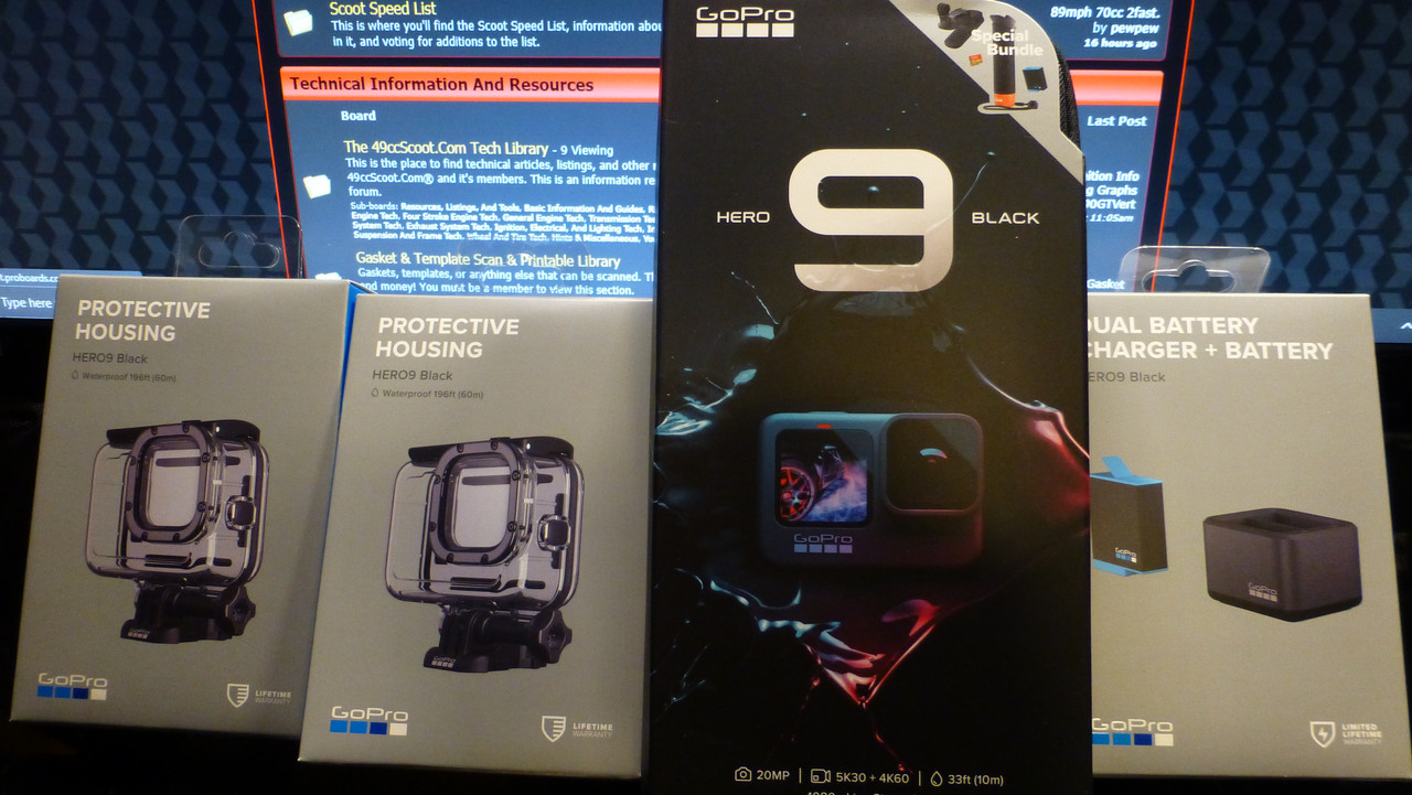

I decided to just wait for the carb rebuild kit instead of doing it with parts from another carb that are also old and well used. It was supposed to be here Sat. Worked out nice, so I could get it together and then ride Sunday. No show. Supposed to be here late today now. I replaced my broken GoPro Hero4. I knew I needed to upgrade anyway since looking at Ryan's Hero8 footage beside mine from the car show in October. I've also got a roll bar mount with rubber inserts on the way so maybe I can mount it without immediately tearing it up trying to film the CVT area. You can mount the 9 without a protective housing, but I read that the built in mounts have broken before and it's constantly hit with bugs and such so I got housings to mount on my helmet and scoot as well. Just need to figure out how to get decent sound, hopefully some mic fur over holes drilled in the back of the housing like my old setup. So much for a better engine kit, I'm tearing up cameras instead.
Post by captincvmn on Nov 23, 2020 14:33:46 GMT -5
Really nice looking and needed improvement. As much as you do for the two-stroke industry you deserve a sponsor

I think i saw you post something about a lectron carb, are you going to use it on this scooter?
Post by 90GTVert on Nov 23, 2020 17:00:53 GMT -5
I think i saw you post something about a lectron carb, are you going to use it on this scooter? Eventually. At least long enough to see if I instantly reach 100MPH. It's a 30mm HV Lectron. It looks like a PITA to deal with on a scoot where you want storage. Bigger and the intake setup sucks for the real world vs what I have now that's very low. I don't even have any airbox setup for it. Just a pod filter. Not a fan of those, but it's not worth even more $/effort till I see if it does anything for me.
