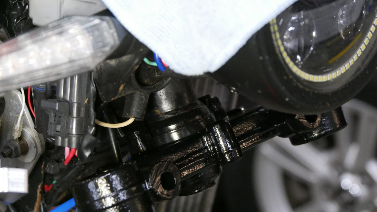

Post by 90GTVert on Jul 20, 2022 16:45:58 GMT -5

I got the front end wrapped up yesterday. I ended up using the 37x52x8 seal for the lower bearing. There's a raised area just below where the race goes that it fits around. I had to cut out the actual sealing lip on the inside though. It's too tall otherwise. So basically the seal is turned into more of a cap or cup. It's just the right thickness that the bearing race holds it very snug once installed by sandwiching it between the race and the stem, but it doesn't prevent the race from going all the way on. Fitting that way, sealing against the center would seem unnecessary. It's a very snug fit around the frame. It sits at an angle though, because the clamping part of the stem that the seal sits on is angled slightly relative to the shaft. That means it's covering more in some areas, but it does at least cover all the way around. The seal adds some small amount of friction when turning. With just the stem installed, I was afraid it may be an issue. Once I got the weight of the bars and the forks and wheels added, it didn't seem like a big deal. Felt good to me on a test ride. I know it's not common to seal here, but I think it's a good thing. Even if this isn't incredibly effective, less dirt/dust/debris is still better. The spring cutting didn't seem to make a major change, but I think it sags a little less with my weight on the scoot.
