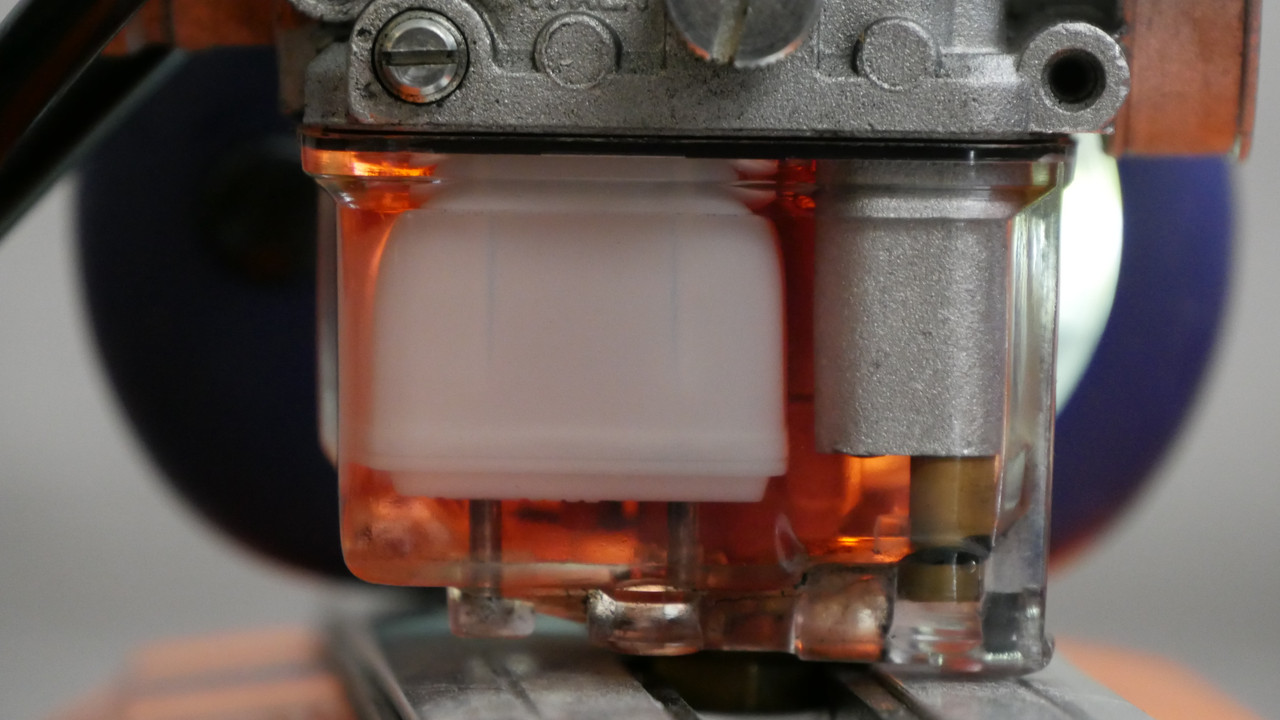

Here's a vid from the 170MJ watching the clear bowl. The video isn't very clear because the GoPro doesn't want to focus that close, but you can see fuel level fine. One time it decides to drain the bowl and another it seems like it could go all day.

Do you think clocking or leveling the carb would help ??
From the video it sounds good till it drained the bowl
Not sure why 2nd run didn't drain it, so it seems like it is only draining it randomly
Post by oldgeek on Aug 11, 2022 11:50:13 GMT -5
Is the float binding? I know everyone does it, but I just don't see how a carb can work correctly at that angle, or any angle for that matter. There has to be a better way.

Not sure why 2nd run didn't drain it, so it seems like it is only draining it randomly That's what I don't get. I even got variations when testing flow. I can see in there and there's nothing floating around in the tank. Pretty sure the outlet was clean. Cap on or off didn't matter. Not much left with a simple gravity feed setup... unless the RC-One changes gravity. Maybe that's actually how the front end gets up so easily? I don't disagree that a level carb is more ideal... but why does everyone else use them like this on all sorts of setups and I don't hear about such an issue... and again possibly more importantly is why does it work most of the time and then sometimes it doesn't? I thought maybe the float was sticking as Scott said too, but I watched the vid a couple of times where it drains and it seems like it wasn't stuck to me. It's down where it should be letting fuel in and still draining. There are 2 crappy things about the angle here. First, the main jet is basically in the center and the highest fuel level is at the front (of the scoot) so it's not benefitting from the most fuel access. Second, the floats are where the highest level of fuel is, so they are more likely to stay higher than they would if level. If there's any good thing, at least fuel does slosh backwards on acceleration to some degree... but that seems mostly at launch when fuel levels are always fine anyway. I really don't want to level the carb out by changing things around just because I don't see why mine needs this. Something else has to be happening. I should probably drain the whole tank again and run something through the barb on the tank. I wouldn't even think it should be that though, because my fuel lines and filter look filled. I'd figure that volume should cover an acceleration run... I guess unless it were totally blocked and holding fuel due to lack of venting, which I don't really think is happening. Based on previous observations, I don't think I can raise the float height to any significant degree without getting back into overflow problems.

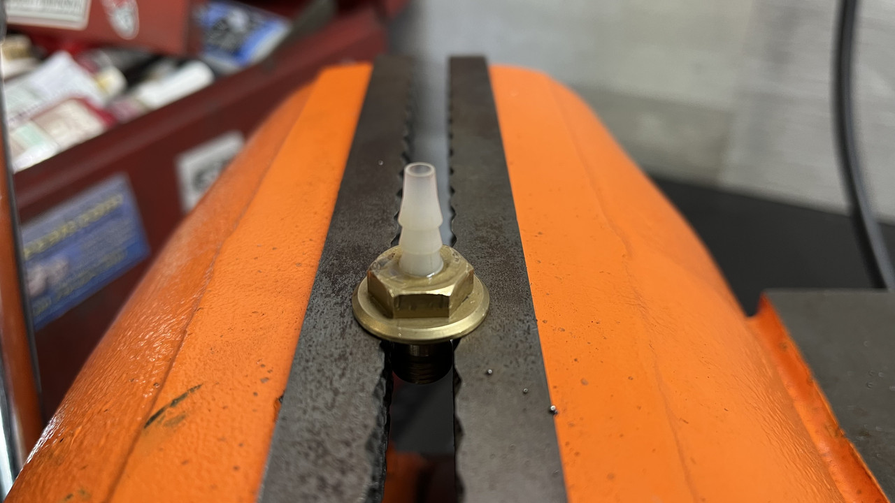

Post by 90GTVert on Aug 12, 2022 13:04:17 GMT -5
Success!!! Maybe...
I started testing fuel stuff this morning. All are 30 second flow tests.
Prior setup : tank > 1/4" hose > 1/4" shutoff > 1/4" hose > 1/4" mesh filter (or metric equivalent) > 3/16" hose 50-175ml (varying depending on exact configuration)
Test 1 : tank > 1/4" hose > 1/4" shutoff > 3/16" hose 425ml So, removing the filter jumped flow up from 175 at best to 425ml! I wasn't ready to accept that a simple strainer type screen filter was that restrictive. I initially had it running straight down from the barb, and questioned if routing it roughly 90 degrees bent right out of the barb could be the restriction. Zip tied it up that way, as it normally is, and it made no difference.
Test 2 : tank > 1/4" hose > 1/4" shutoff > 3/16" hose > 1/4" mesh filter (no hose on outlet) 375ml It looked like the filter restricted flow by about 50ml in 30 seconds. Still way more flow than I had, so something else was going on.
Test 3 : tank > 1/4" hose > 1/4" shutoff > 3/16" hose > 1/4" mesh filter > 3/16" hose 450ml Now it's flowing more with the filter and the 3/6" hose on the end than it was with just the hose coming from the shutoff and no filter at all!
Then I wanted to try putting 1/4" hose back between the shutoff and filter and using 3/16" after. At this point I'm suspicious that the large hose before the filter and small after causes a restriction. Maybe back pressure or head pressure or whatever it's called? I went to pull the 3/16" hose off of the Malossi filter and it ripped the end off of the filter. Perfect.
I didn't have any other 1/4" filter like it. I did have the Malossi filter labeled 6mm, which actually matches up to 3/16" well. The 8mm, is really ~1/4" which is why it's labeled that way to make sizing more clear. I zip tied the 1/4" hose on the filter from the shutoff to make it seal and see if I could test my theory with the smaller filter or not.
Test 4 : tank > 1/4" hose > 1/4" shutoff > 1/4" hose > 3/16" mesh filter > 3/16" hose 375ml Back to where I was with no hose on the outlet of the 1/4" filter, so I thought this may also improve by switching to smaller hose pre-filter.
Test 5 : tank > 1/4" hose > 1/4" shutoff > 3/16" hose > 3/16" mesh filter > 3/16" hose 450ml Boom! Right back to the high flow numbers by adding what I would have thought would be a more restrictive hose.
Then I was really disappointed that I couldn't see what the effect would be having the larger filter with hose diameters changing since I couldn't find any more 1/4" filters. I went to check the shed, because the mowers use 1/4" fuel filters and I had one around. It was a paper type, not the screen. Eh. We'll see. I angered the wasps above the shed door on the way out and one stung me in the neck. Small price to pay for the test filter I was after.
Test 5 : tank > 1/4" hose > 1/4" shutoff > 1/4" hose > 1/4" paper filter > 3/16" hose 450ml OK, maybe not. This seems fine with the mismatch on each end of the filter.
Test 6 : tank > 1/4" hose > 1/4" shutoff > 3/16" hose > 1/4" paper filter > 3/16" hose 450ml No change.
This was 3x or more the average flow from prior testing, so good enough for me. I wanted to do one more test to see if having the hose a bit more straight down than my usual routing was a major restriction. That flowed 425ml. Makes sense I guess. Going much more straight down would seem like an advantage in a gravity feed fuel system. Still, tons more flow than I had.
At this point, I'm guessing my bowl emptying issues will be cured, but no test runs yet. You can just look at the fuel coming out of the hose and clearly see the difference from the past tests or watch how quickly it fills a container. It's obvious.
I also noticed that the 1/4" mesh filter would not fill during tests with 1/4" before it and 3/16" after. Then with 3/16" on both sides, the filter would fill and stay full. The paper filter didn't seem to care. Maybe because the paper element offers some sort of restriction or isolation that the screen doesn't or maybe something else I'm missing in the design.
The main thing that I learned here is to match fuel hose size on both sides of a filter. Even with paper, after seeing this I would still match it. Again, I can't tell you technically why, but it appears that some sort of resistance or pressure is better than just an open hose. Another one of those times where relying on intuition fails me, thinkng that bigger wherever it'll fit flows more.
I'm also probably not going to bother buying costly scoot/moto filters anymore. I'll just pick up auto/mower filters like most people seem to do anyway. Now I'm just hoping the one on there isn't junk. I had a Kohler filter that's a monster and then some no-name filter. I have had generic filters come apart while riding, so I guess I should make sure I have enough hose under the seat to reach from shutoff to carb just in case.
TLDR : Match hose sizes on both sides of the filter and maybe don't bother with expensive scooter/motorcycle filters over cheaper name brand automotive/mower stuff.
