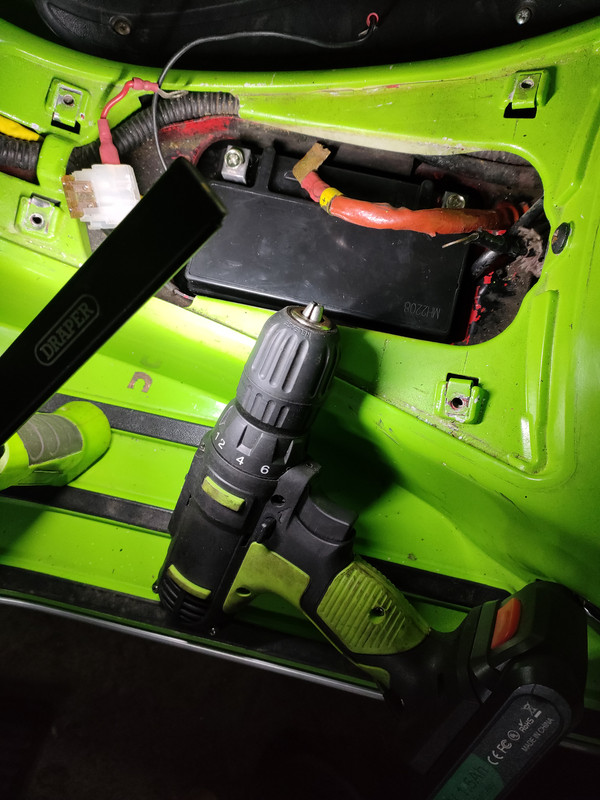

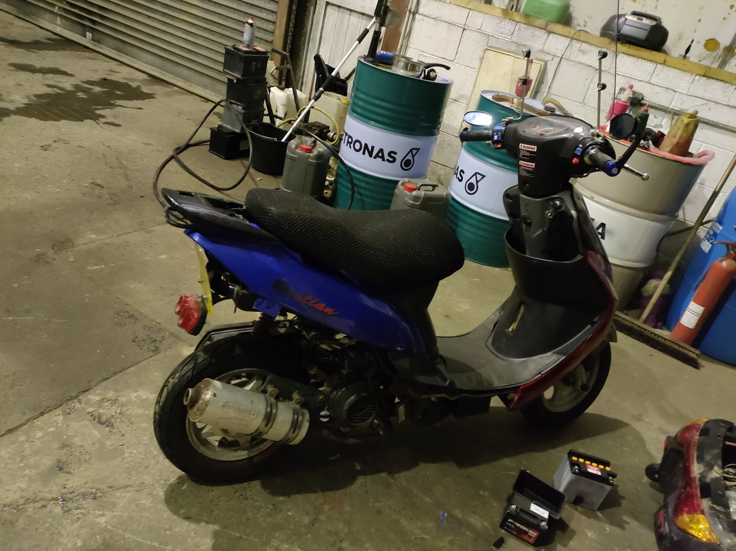

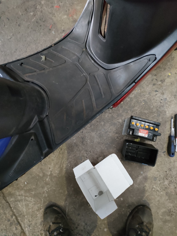

Today is blooming battery day. First the GTS battery terminal broke being as old and brittle, then it was time to fit leads and a spare battery on the rat scooter in the bucket but need slightly longer battery bolts. At least the damn mobility scooter batteries went back ok and are charging.

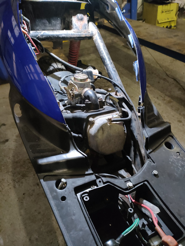

Well been going round in circles on this one. Lowered compression, new battery, starter, starter solenoid, still pig on starter. Main battery leads appear ok and all terminals clean.clean.Just used jump pack starts fine replaced or rather added some extra stout leads to earth and solenoid just one more in morning from solenoid to starter motor and see if works ok. Got a buyer who really wants it but ain't going like it is. If still problems see if he wants it as is to finish off.

milly , To check your starter system look for a large voltage drop across connections, components, and wires. The starter itself is the only one that should show a large voltage drop.
