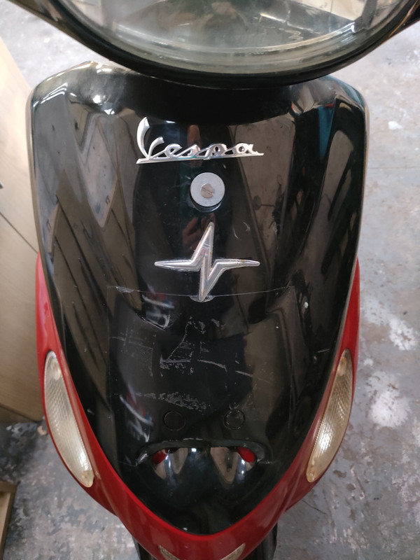

Well I am stumped. Even putting a jump pack directly to starter it turns slowly exactly as it did with old then a moment later using the normal key system it wizz away and start. I am thinking of see if the Variator has any problems as in bent dunno. Clutching at straws now but the outer pulley is the last thing that spins the crank. All the rest of the system back has been renewed or upgraded 🤔
Post by aeroxbud on Dec 11, 2022 8:42:05 GMT -5
Well I am stumped. Even putting a jump pack directly to starter it turns slowly exactly as it did with old then a moment later using the normal key system it wizz away and start. I am thinking of see if the Variator has any problems as in bent dunno. Clutching at straws now but the outer pulley is the last thing that spins the crank. All the rest of the system back has been renewed or upgraded 🤔 Perhaps try removing the belt. It might give you an idea of its something to do with the CVT, or before that.
Post by milly on Dec 11, 2022 9:27:57 GMT -5
Thanks I shall try that this afternoon when back from grandkids later aeroxbud
Post by milly on Dec 11, 2022 12:17:22 GMT -5
So Variator removed and belt put the end Variator pulley back on and wonder of wonder's it starts. Not checked Variator or belt to damn cold. Job for another day
