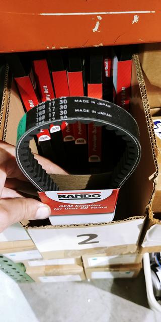

Post by fugaziiv on Sept 21, 2018 8:10:14 GMT -5
Just a regular poly belt Japanese Bando. Every Bando on our site is Japan made; we don't sell any of the Chinese made Bando belts. Matt That's good to know, all this chinese knockoff crap sorta pisses me off. I am still quite new to the scooter world. So is there at least discernible differences in the logo or packaging that a savy scooter guy could tell the difference? Well, to be fair, the Chinese made Bandos aren't necessarily a knockoff. Bando does have a Chinese production facility. If you want to buy Japanese bando, just stick to our site. We're the only importer for Bando Japan in scooter sizes at the moment in the USA that ONLY imports Japanese product. Matt
Post by dexameth on Sept 21, 2018 8:19:18 GMT -5
Yeah, our Bando's are easy to tell where they come from
Post by fuzzyruttin on Sept 21, 2018 8:39:50 GMT -5
It's difficult not to be cynical... how hard would they be hit if the chinese-manufactured belts were stamped with "made in japan" and they got caught? Sorry, not to drag this on
