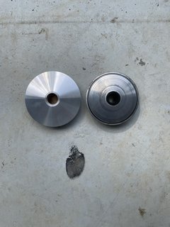

Post by bigmatthew86 on Aug 3, 2022 17:38:45 GMT -5
Installed the variator, 11g sliders, & new belt. Hit 55.6mph on the same road so I picked up 2mph. Air filter is pretty dirty so I ordered one & will change the oil & plug as well. Dr pulley variator is 118mm vs 113mm stock.

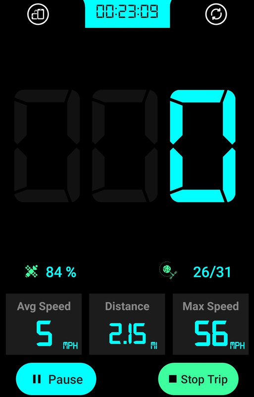

Just did a GPS run , 53 sitting upright 56mph in a tuck. This scooter is 100% stock. I'll try to do the modified one tomorrow.
