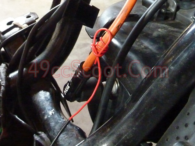

Wrap the signal wire around the spark plug wire a few times. I know with some other tachs people discuss how many wraps it takes to get a proper signal. I just wrapped it around as shown, tested, and it worked.
