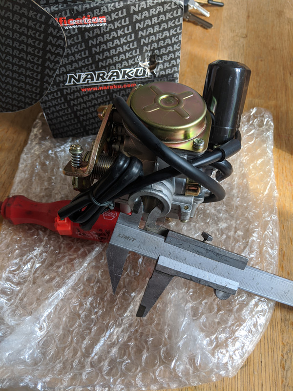

Naraku NK200.01, Supposedly 20mm, 18mm IRL. EDIT: Answer from Naraku: Dear Petro, i just checked with R&D dept. the V.3 version of nk200.01 is 18mm. The v2 version used to have 20mm but the carb was difficult to set up and no power increase. Thats why its changed to 18mm in the latest version. We will inform our distributors to check their descriptions. thank you!
