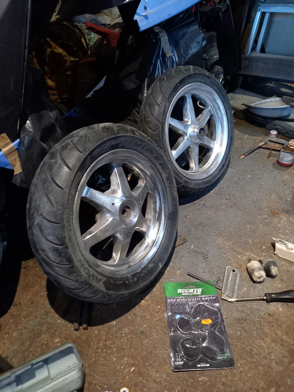

Post by geoffh on Dec 5, 2020 9:39:19 GMT -5
This is a long slog :'(I was going to log the time it took to strip these but it,s a labour of love and vanity now so I will just keep track of the material costs,another set of wire wheels for the drill total now £30.that said I am getting there with 20 30 minutes a day and no real deadline they will be done for spring ish .  Geoff

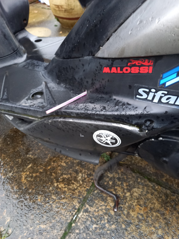

Post by geoffh on Dec 13, 2020 9:58:46 GMT -5
So moody has been playing up by almost starting but dying after a second or so and then refusing to start till it got a sniff of easy start,yes lazy I know but I have to get to work.I stripped the carb down and as expected the pilot jet had a tiny spec of dirt in there! so rebuilt and left overnight started first kick this am.I have drilled a hole in the panel that let's me use a straw to introduce easy start directly into the snorkel a simple improvement that makes a huge difference at 7am on a cold day. Geoff

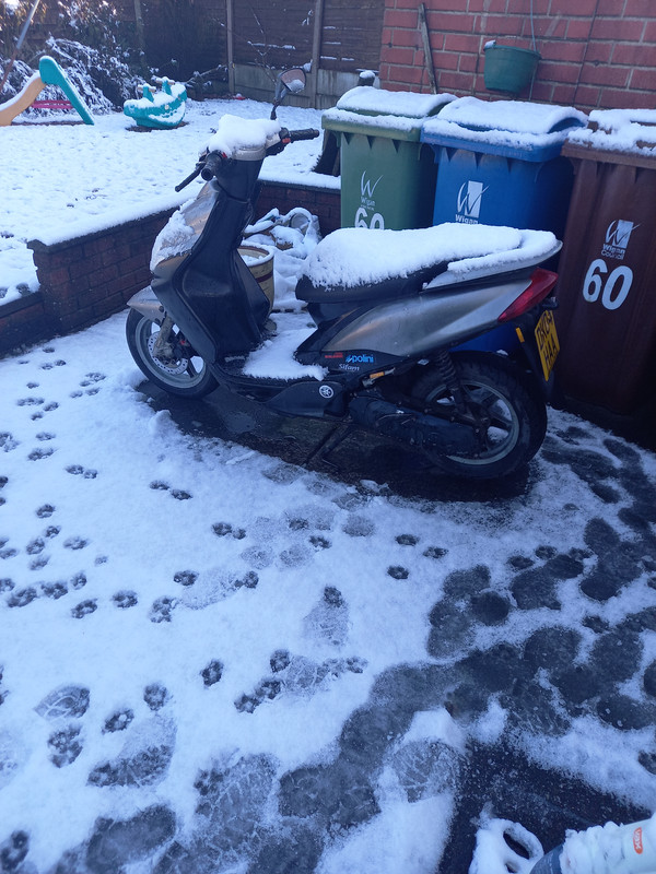

Post by geoffh on Dec 28, 2020 9:39:04 GMT -5
So I have lived with the no start problem,scoot runs well once started and shows no hesitation starting while warm or up to six hours after that it needs easy start to get going.yesterday I swapped out the pilot jet for a spare I have lying around (no numbers on either) the old pilot jet looked just a tad smaller or maybe a little coated and way to small to photograph,result 8 hours of chilling it started easily so I left it overnight and unusually added a layer of snow to the scoot but it started up first kick,job done I hope. Geoff
