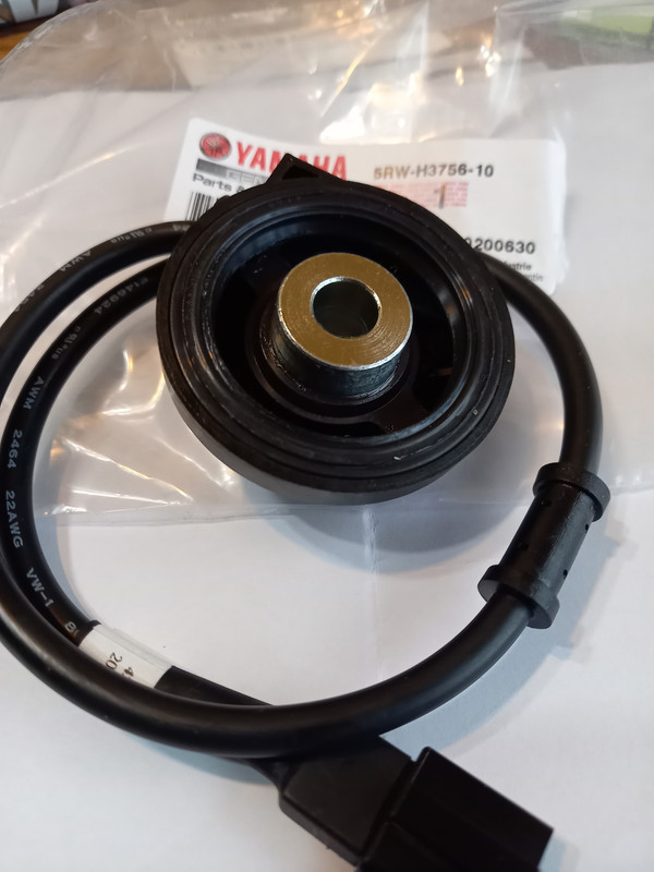

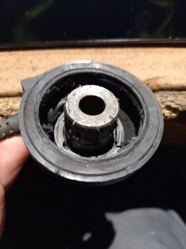

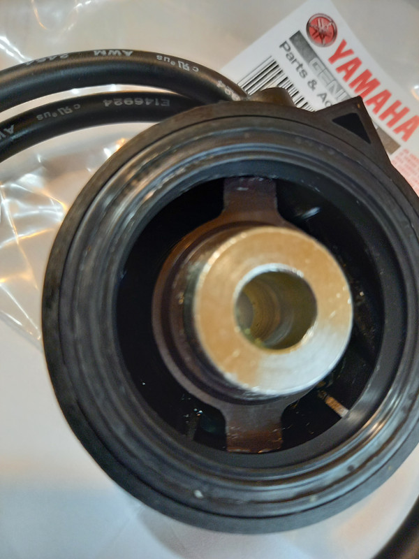

Same old daily plod,no problems so I treated the scoot to a new speedo drive £50, it stopped working some years ago and my "fix" stopped working a year ago.from the factory this was a sealed unit with a sealed face that needed to be smashed off ,the rotor removed greased up and spaced just right to revive it,surprisingly the new one from Yamaha now has access to grease it in service part number 5RW H3756 10.the seal is 52mm 40mm 6mm and the rotor needs to sit 8mm below the central hub.  Shiny new one

All the Yamaha ones I have had apart are a bit different to that. Even my 2002 slider was different. I wonder why they didn't use the same part on all their scooters?

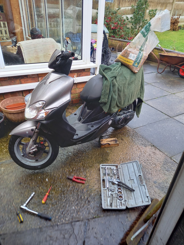

The scoot picked up a lesser spotted squeak on the front brake disc,so a strip down, clean of the pads and some anti seize grease applied to the back of the pads cleared it up.   as you can see the scoot is starting to show its age I think I will wait till spring and revamp the running gear. Geof

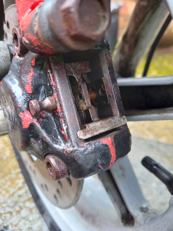

The brake squeak has returned!!! I think the master cyl spring is weakening but it,s not available as spare part from Yamaha,? Would this cause the caliper piston to not return or am I barking up the wrong tree.here's a picture of the innards (have to post it later).It,s a grimeca cyl and I find a lot of vespa references in catalogues but none quite nail it,does any one recognise this cyl? my other thought is to put some washers under the spring to "beef" it up,any thoughts Geoff

I think only the Brembo brakes have a rebuild kit. You can buy a new pattern master cylinder for about £20. You can get a build up of dirt behind the dust seal on the caliper. This causes the piston not to return.
