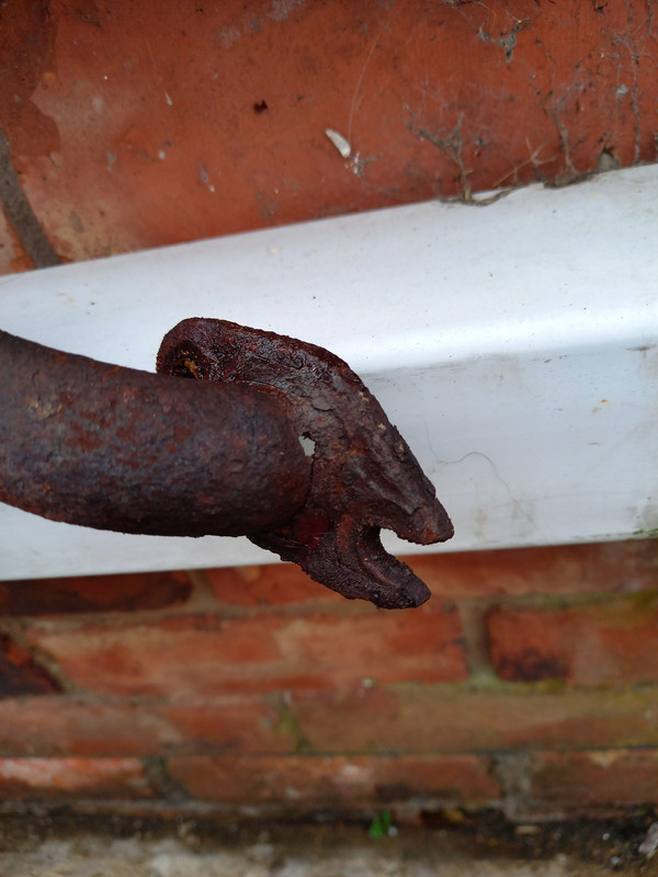

Post by geoffh on Jul 4, 2020 14:26:31 GMT -5
Hi scoots running well,here's a picture of the failed naraku it,s only a year old I would love to find a way of repairing it,any ideas??  Geoff
Post by aeroxbud on Jul 4, 2020 18:50:25 GMT -5
I'm sure a good welder could fix it. Depending on the price though it might be best putting the money toward a new pipe. Anything like exhaust repair paste won't last. You can tell you ride all year round like me! 😆
Post by geoffh on Jul 5, 2020 14:49:37 GMT -5
Welders don't,t run in the family so I,m a a bit stuck I will have to get used to the idea of replacements every time it happens,funny the exhaust cost,s more than the whole scoot did as a non runner.

Post by geoffh on Jul 6, 2020 15:30:37 GMT -5
It looks to far gone for welding ,shame the first naraku lasted years I will just stash it under the bench for now and see how long the technigas holds up to the salt attack.
Post by 190mech on Jul 6, 2020 19:35:26 GMT -5
It does not look like much steel is left there to weld,perhaps the entire headpipe/flange could be replaced if the body has little rust...

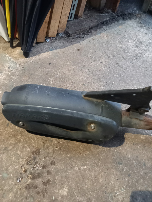

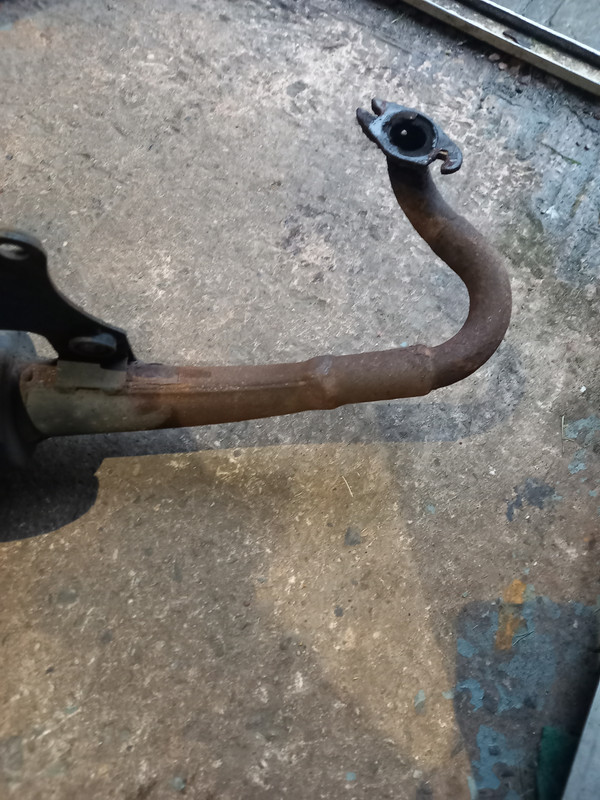

Post by geoffh on Jul 7, 2020 14:59:57 GMT -5
Here's the body hardly any rust,and the restp of the pipe,I have tied to find a head pipe and cannot, thought about flex exhaust tube but that gets expensive and will be hard to seal,I,m going to man up and ditch it soon.   Geoff
