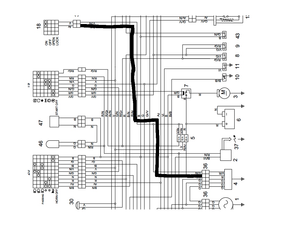

So in my quest to get all of the scooters on the road I pulled the Scarabeo out. I had charged it with a Battery Tender and the battery was good. I went to start it, turned the key and nothing. Usually all of the lights come on and of course the brake lights work. I tested all of the fuses and they were good. I tested the Ignition switch and it was good. Checked all of the connectors and they were good. Battery is good at 12.56V. I tested the kill switch and it was good. There is a wire from the ignition switch that runs to the voltage regulator. Could the voltage regulator be bad? here is a picture of that wire and the full diagram, 4 is the voltage regulator:
Post by jloi on Apr 4, 2020 19:30:01 GMT -5
I'm so jealous of people that have ACTUAL diagrams/schematics for there scooters .
Post by 190mech on Apr 4, 2020 23:26:30 GMT -5
What is switch "18"?
Post by pinkscoot on Apr 5, 2020 6:55:44 GMT -5
18 is the ignition Key switch and it tests good.
Edit: Thank you 190mech you just gave me the path that I need to check to see where the voltage is stopping. I've also been thinking that maybe cleaning up the connectors might do it. It worked when I parked it 4 months ago and nothing now. What could have happened, corrosion. It does Sid in an unheated garage over a concrete floor. Maybe 17years of slow corrosion hit that tipping point. I'll try new fuses that are clean and shiny and clean up the fuse holders. Let me chase the volts and do some cleaning and I'll report back what I find.

Could just b oxidation in the fuse box? (my experience) Would have immediately suspected break switch. Hm? Have you checked that starter relay? We had to replace it.
Post by pinkscoot on Apr 5, 2020 13:43:52 GMT -5
I shorted across it and nothing. I will check that there is power there like there should be.
Post by pinkscoot on Apr 5, 2020 17:11:21 GMT -5
 Found the problem, dead battery. It had the voltage but not the ass. I put the meter across the terminals turned the key and nothing. Oh well I should have started there, it would have shown a short. I put an old battery from the GTS in and it started up. I have a new one on order but I should make it down for an inspection and get tags on it.

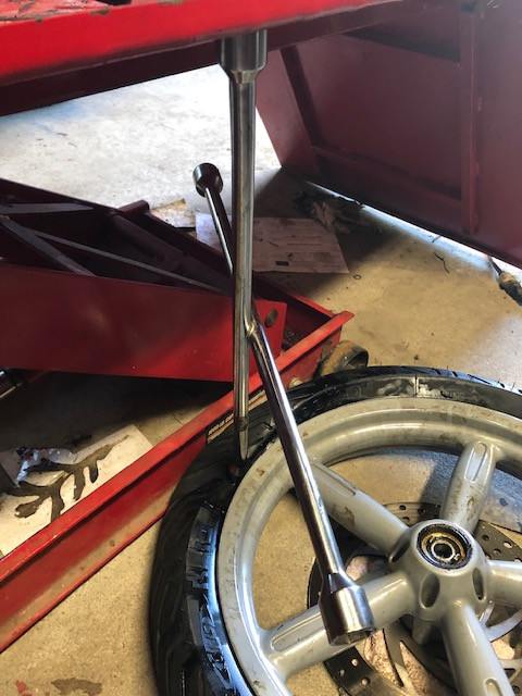

With sometime on my hands I decided to put the front tire back on facing the correct way. Michelin could do a much clearer job labeling the rotation on their tires. So once again I could not get the bead to break so I asked Mr. Google what to do and saw a guy lower the front hub of his car down onto the bead lacking a car on a jack stand with out the wheel on it I used what I had:  It worked like a champ. the rest was a piece of cake. The scoot does handle a little better with the tread rotating the correct way.
