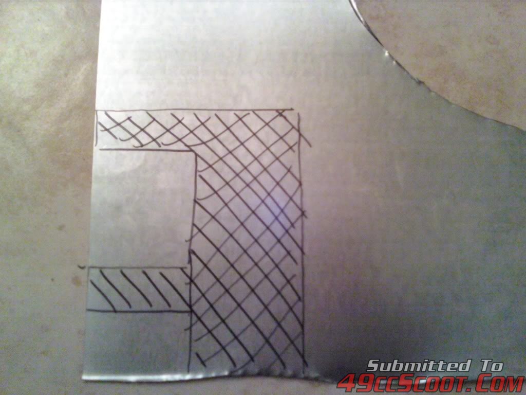

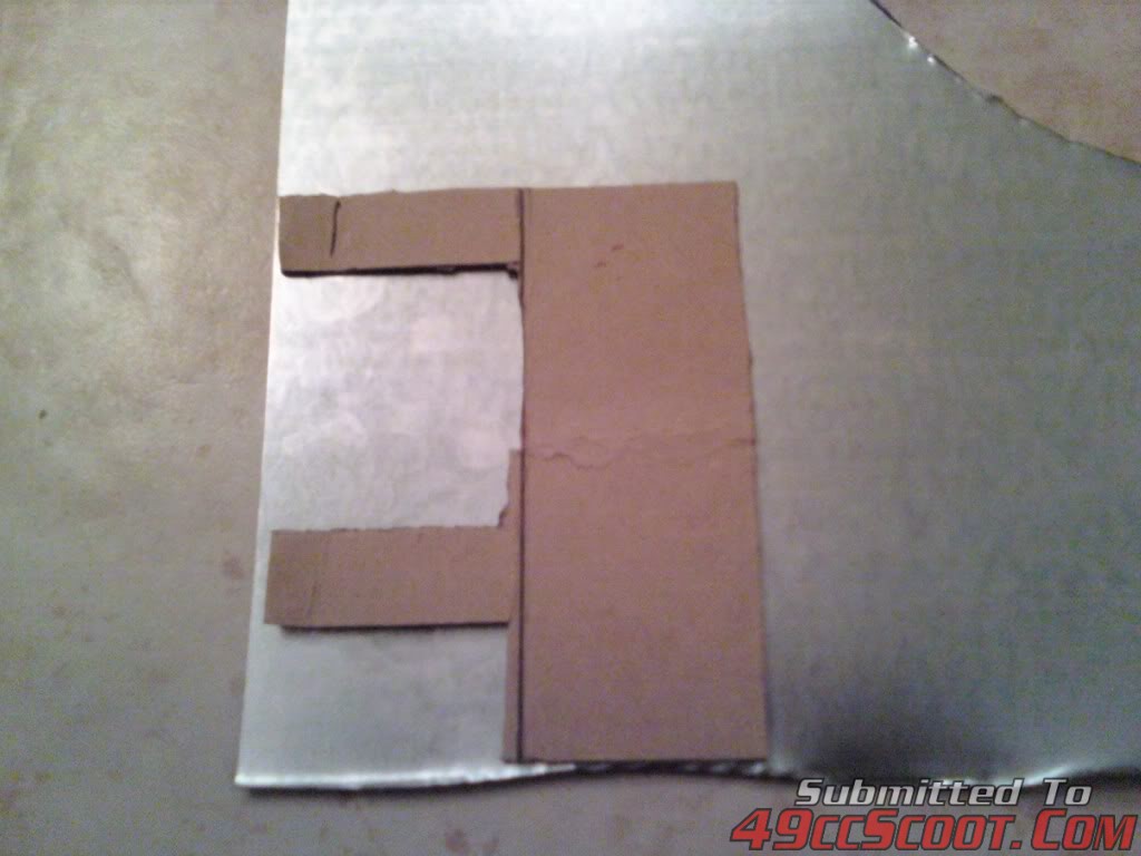

I got some small reflectors, a small Maui Built Sticker and some screw on spikes for "make Shiney"   First, Find two bolts on the air box or.. if you use a UNI filter, just use two bolt in the back of transmission.
 Then grab some card board and make a template, this way you can figure out exactly how you like'm. After that trace the template onto the sheet metal!   I used multi directional metal sheers. (yellow handle)  I cut it out and started bending it! If had jagged edged just sanded it down!    After that, I primed it with Rustolium raw metal primer and Matte Black.  I put on the reflector, sticker and spikes!     Thats it! Now go outside and cut that ugly fender off and fabricate a tag plate! ALOHAZ!
