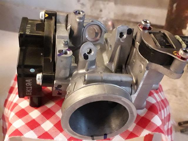

I just swapped some parts on my FI upgrade, from a 36mm throttle to a 38mm. No big deal! Except the bolts. Keihin/Honda does some extended, over the top measures to prevent something... The security torx was part, but they were filled with a black epoxy as well. Luckily external. Since I TIG weld aluminum/aluminium...hehe, I always have some acetone handy. A few small cotton swabs to clean...and good to go? NO! Cheap ass bolts, even pin heads still can screw you!
One came out with the proper tool...the other stripped too easily. STOP! Grind a flat!
The photos suck, but you get the idea. After grinding a flat, one hit with the Whack-a-mole impact hammer and done...
Notice the Loctite red on the outside. For this application, an idle air sensor, it wasn't right to thread lock, so this is what I call bolt head "Bead Lock". You should also note that I found some high quality Torx head screws. You could use silicon, but it is ugly.
Here is the new 38mm throttle ready for install:
