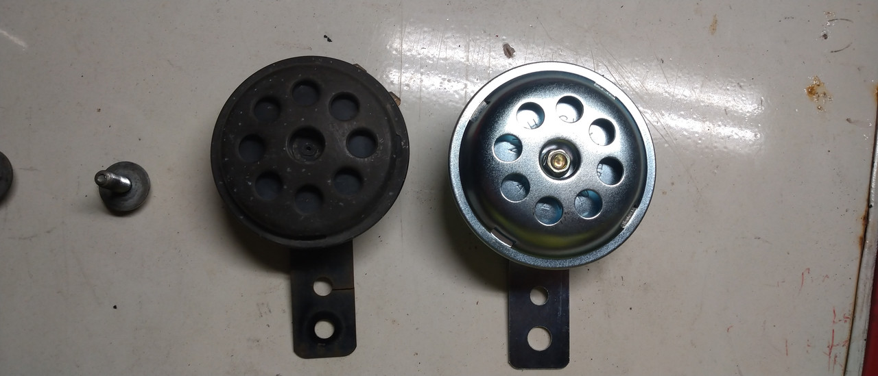

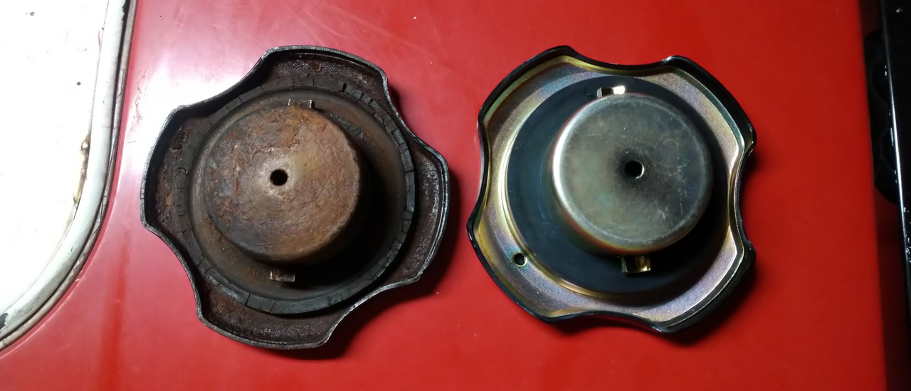

Post by birdman on Mar 12, 2020 14:11:03 GMT -5
A couple more tidbits while I wait on the petcock valve. New oem cap. The rusted out original was just begging to be relieved of duty. New horn, the original didn't work.
