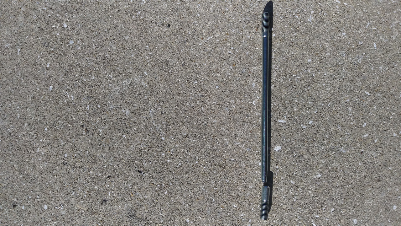

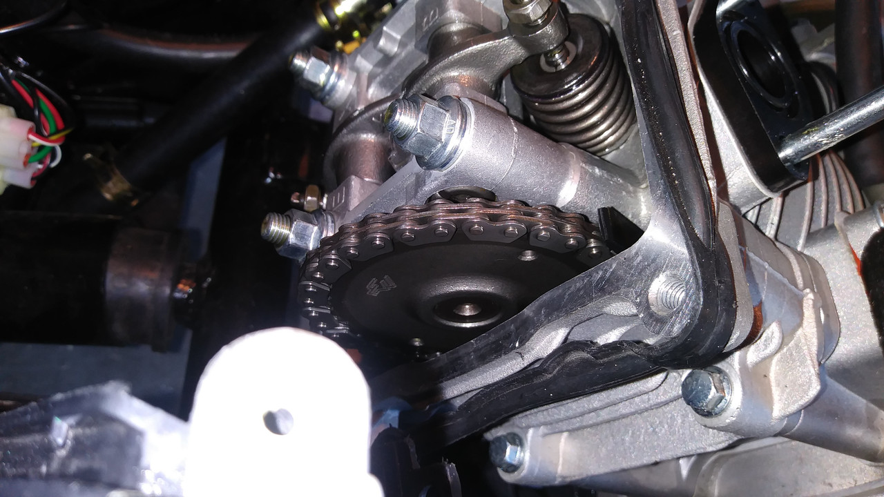

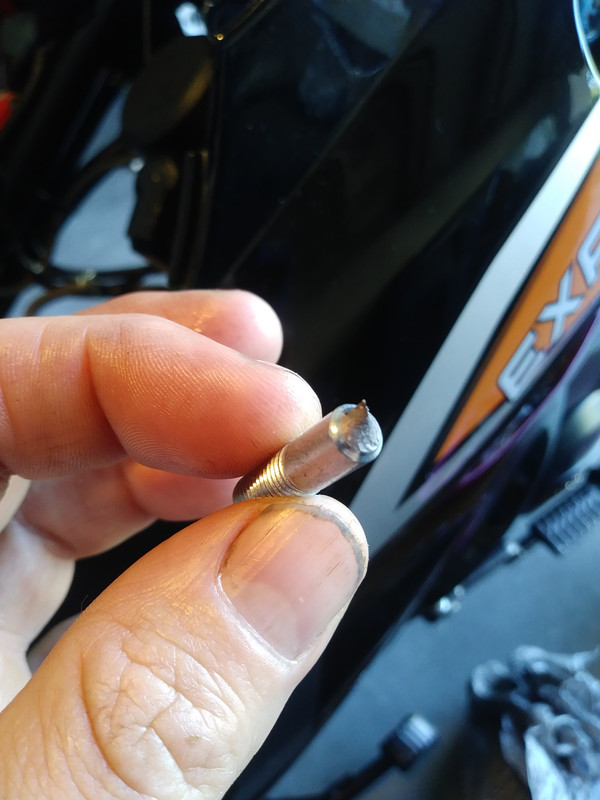

 So you can see i totally screwed the pooch on the cam, not only was it backwards but it didn't line up at all. No worries, immediately saw what was wrong, took everything out, got it back lined up correctly, everything was going smooth. took my time and in a star pattern, butting the head bolts on slightly snug, taking my time, then got my torque wrench out, set it up with 13 ft pounds and in a star pattern again- not in a rush, started to torque down my head bolts... then the upper right long head bolt sheered off.    so back to square one. if you can notice the "core"" of that head bolt looks like taffy, cheap crappy Chinese metallurgy. i hopped right on and ordered some of these studs to replace the one i busted. i might as well do all 4.
so that's where i stand. dead in the water. at least it sheered off above the valve head and i was able to get it out without pulling the entire head and jug. im so annoyed im day drinking now.
Post by scooterted on Nov 11, 2019 11:20:09 GMT -5
Oh geeze. You cant catch a break. At least youve found the problem, and extracting that stud didnt sound like it was a problem. Dont worry about the cam being in backwards, not possible. Cam position determines what stroke the crank is on. Just make sure the crank is at top dead center and the two small holes on the cam gear are level with the top of the head and youll be fine.
