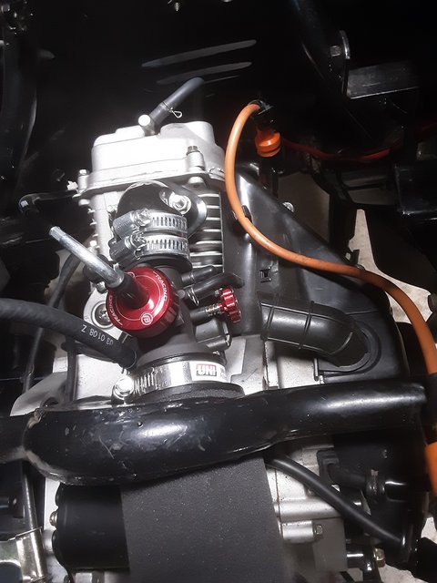

Post by rocketdogiv on Jun 22, 2020 19:16:56 GMT -5
Here's what I'm running at the moment. A 172cc. Make sure you check the valve clearance. I don't know if an A9 will clear a stock piston and head.
Post by CrankingWithCG on Jun 23, 2020 0:01:12 GMT -5
Daaaamn thats clean! I compared it to my stock piston, wristpin holes lined up, theyre the same height as far as i can tell. And the valve reliefs are at least twice the size, both in size and depth. I don't think ill have issues, while my old setup only topped 6700rpm, there was no valve contact. And i got some pretty stiff springs. I wanna get the polini clutch and a lighter clutch bell at some point. Gonna port the head as well, so it should let that cam breathe
Post by rocketdogiv on Jun 23, 2020 13:13:27 GMT -5
Sounds good Big, good luck to you. Let us know how it turns out.

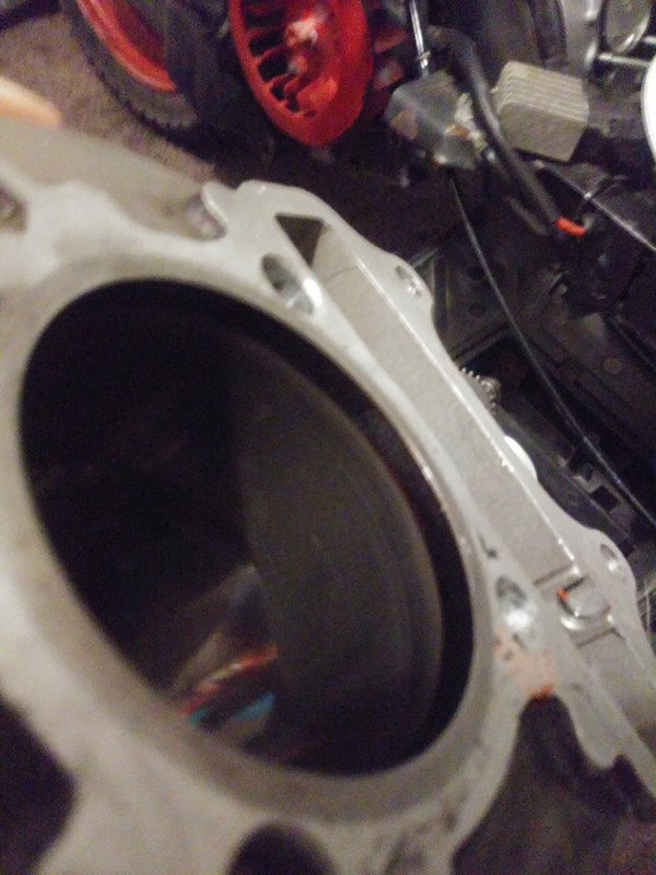

Post by CrankingWithCG on Jun 23, 2020 23:04:34 GMT -5
Ohhh boy. May have to cut valve reliefs after all. The black ring is the unused part of the cylinder. Compared to the new one.....i smell too much compression for my weak ass to kick 😂
Post by rocketdogiv on Jun 25, 2020 20:56:05 GMT -5
Let me go look at some of my old stock cylinders. Looks about normal to me Big. I looked at one of mine and with just a 60mm bore a stock head should be ok, as far as compression ratio goes. Run high octane to be sure.

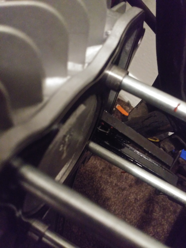

Post by CrankingWithCG on Jun 26, 2020 0:45:19 GMT -5
Let me go look at some of my old stock cylinders. Looks about normal to me Big. I looked at one of mine and with just a 60mm bore a stock head should be ok, as far as compression ratio goes. Run high octane to be sure. I put it all together and kicked it over a few times, and theres no damage on the valves or piston. Im just worried about at higher rpms the valves hitting the piston due to the way smaller gap between them.
