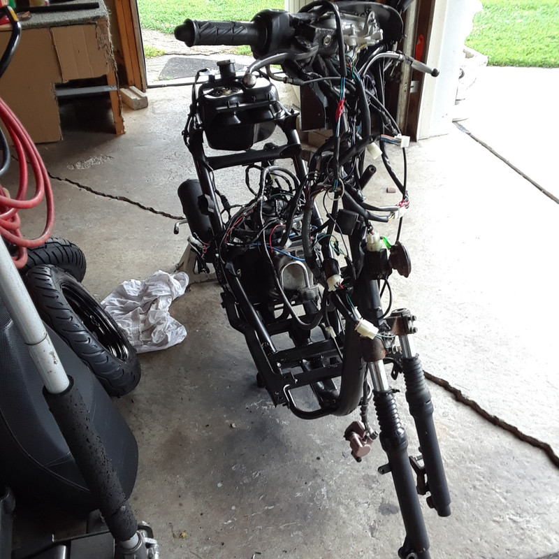

Well here's an update on resurrecting the dead Tao Tao. My neighbor apparently has more money than he knows what to do with so I'm completely rebuilding the 50cc from the ground up lol. its a win for me because he keeps paying me whatever i want and I'm getting some good experience from it.

Since I can't get the handlebars straight and because the steering tube bearings are blown out I'm ordering a new triple tree for it too.
Post by FrankenMech on Jun 25, 2020 12:42:31 GMT -5
It must be nice to have money... Just make sure he makes those progress payments.
Once you get them stripped down they really are simple machines.

I am totally hooked on these little scoots for sure. And they really are simple like you said. A lot of people get freaked out trying to understand the electrical especially the stator operation but that too is simple once you get a good understanding of electrical theory. I'm still second guessing myself on whether I should replace the triple tree on this scooter because the handlebars are offset to the right when the front wheel is straight. I think I'm going to start with a set of new shocks up front and see how that lines up to front wheel and handlebars and go from there.

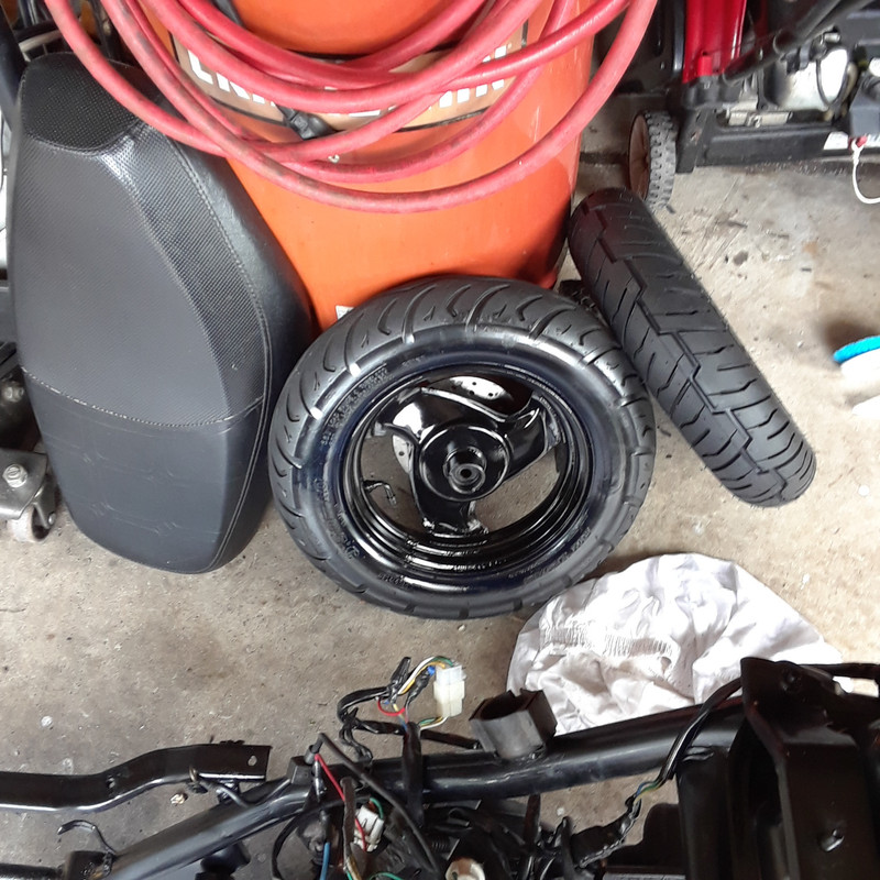

Wire clothes hangers, the second force in the galaxy after duct tape.
I paint the same way. The overspray can be bad.
The stator electrics aren't bad when you realize the 'regulator' on a lot of scoots is a shunt regulator and not a rectifier/regulator. It shunts the negative waveform to ground and excess positive voltage to ground leaving a horrible mash of a DC waveform that drives digital meters crazy. It also gets real hot in operation and fails quickly. If you want some decent readings try an old fashioned analog meter. The higher $$$ and bigger scoots have a good three phase rectifier/regulator.
