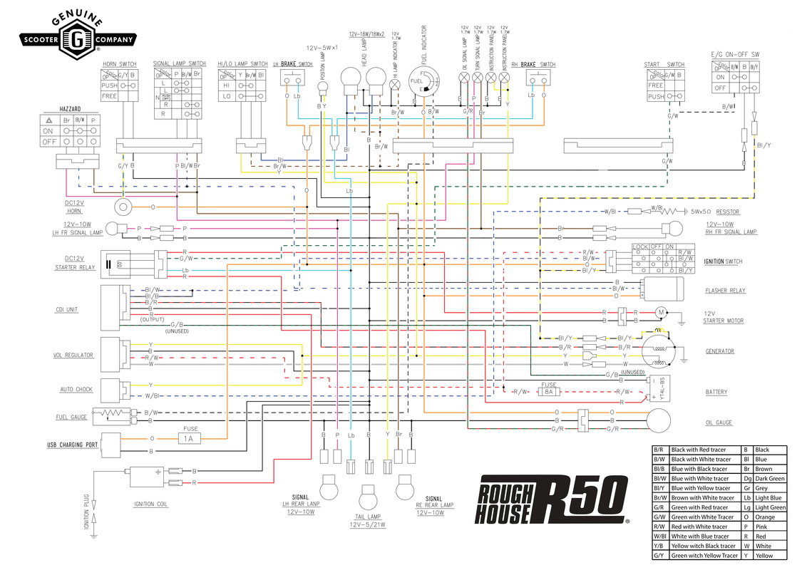

I want to add a USB port to my scooter, and later maybe another small thing, well within the amps range.
If the USB port isn't the type with a light, should I just connect it directly to the battery (with an inline fuse) or should I tie it into the ignition lead or from the stator?
I work on boats usually, and have a fuse block to wire stuff into. Thanks

This is how mine is wired from the factory.
