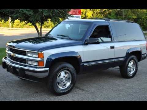

Post by Steve B on Oct 10, 2020 11:21:33 GMT -5
Steve B
Scoot Veteran
Posts: 829
Location: Derby,Iowa
Post by Steve B on Oct 10, 2020 11:24:24 GMT -5
ive always liked those tahoes but they are even harder to get your hands on. and if you do find one its either 10 grand or rusted out. This was the last year of the K5 Blazer before being rebadged to tahoe.
Post by chehystpewpur on Oct 15, 2020 0:08:14 GMT -5
thats new to me but makes sense. when i took the link to it it was tbi and the tahoes i was thinking of had the vortec 5.7 in them. still clean and a nice body though and apparently was around the corner from me.

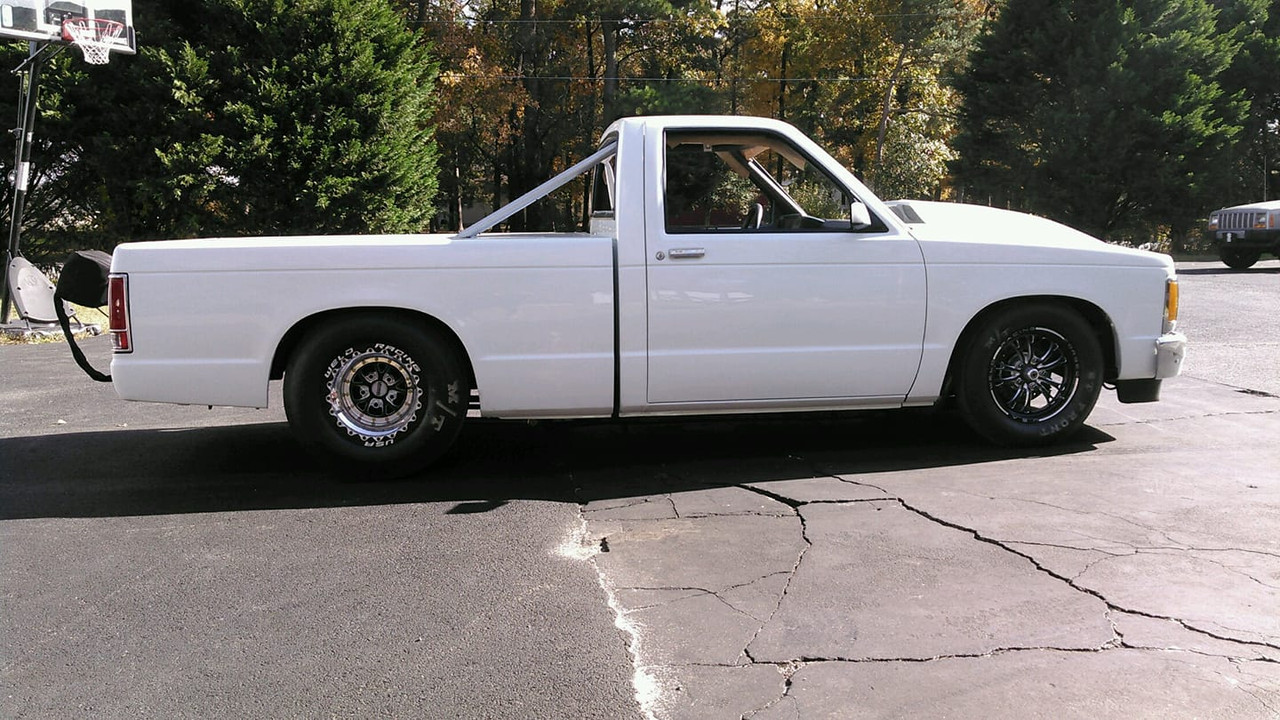

Post by 90GTVert on Oct 25, 2020 12:35:52 GMT -5
A friend of mine had a white S-10 Blazer very similar to that, but with a 4.3 Vortec. He wanted to do a V8 swap someday. Didn't happen because he rolled it. Wet roads, got wild, hit a ditch, crushed the driver's side roof in to the point that it was hard to believe he made it out. He and his passenger were basically fine, but the truck was totaled. I thought he was going to roll it one day before that, also in the rain. He passed a car and ended up fishtailing when he went to cut back in. Another friend's father had the GMC version, Jimmy, and rolled it over in a ditch right in front of his house. It's a nice truck, so try to keep the tires on the road. lol Here's a local acquaintance's S10 truck if you're looking for some future ideas :

Post by Steve B on Oct 25, 2020 12:52:55 GMT -5
I have heard of people doing that with the engines. I like those chevy s10 because the corvette 350 drops right in,
Post by chehystpewpur on Oct 30, 2020 0:22:11 GMT -5
i always liked the pro street look on these little guys but not for me sadly. im still 50-50 on a cowl induction hood but i like the flat sleeper hood that i have. and i have heard these things are rolly and top heavy but i lucked out on mine being 2wd and having the heavy duty suspension and sway bar. it now has 3/4 ton rear leafs and is very flat on the road. i will be installing a rear sway bar next year though. itll go around a corner faster than i would ever feel safe going around one in a truck. dont get me wrong ive had alot of cars and driven many more while i was a mechanic. this will go around a corner better than my 97 bmw 540i that i had with the widest tires it would fit. i plan on keeping it for a daily driver for a while so no worries shes gonna stay wheels down unless shes getting jacked up for repairs or on a hoist. quick side note and an action shot. there is a 1/4 mile strip where i work and one of the guys i work with has a 454ss truck with 30k miles. he finally raced me lastnite after work and oh boy was that fun. 2 truck i always wanted to own on the same strip and it would seem i made the better choice.
