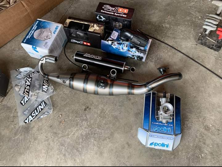

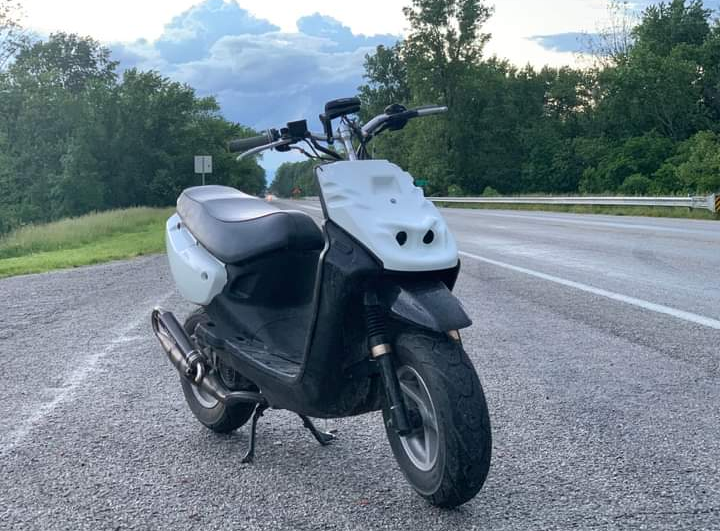

Figured id put this gal up while im writing my build thread on my 155. She was brought to me Friday. Its an 05 Zuma, Polini kit, Yasuni pipe, Polini 21mm carb, not sure on trans or reed setup yet. But Im so damn glad to be back on a two stroke, and more importantly finally own a Zuma. I originally wanted a prebug, but this thing was just too damn cool. And people near me are pricing them up the ass. Shes down at the moment cause i tried getting used to how it comes up and i yanked back on the bars. Snapped em off in my hands. Oh well, got a weight kit, new bars, and grips on the way. Definitely wanna tune the trans. Shes screaming a bit too high at WOT, and i wouldnt mind losing a bit of takeoff. She tries coming up every time I get on the gas. Itll 12 on power alone, and im not trying to get there anytime soon 😂 Pics are from the ad, ill take my own once the bars are set up ^^

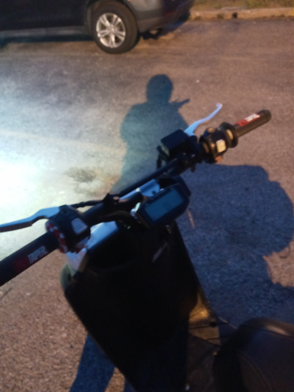

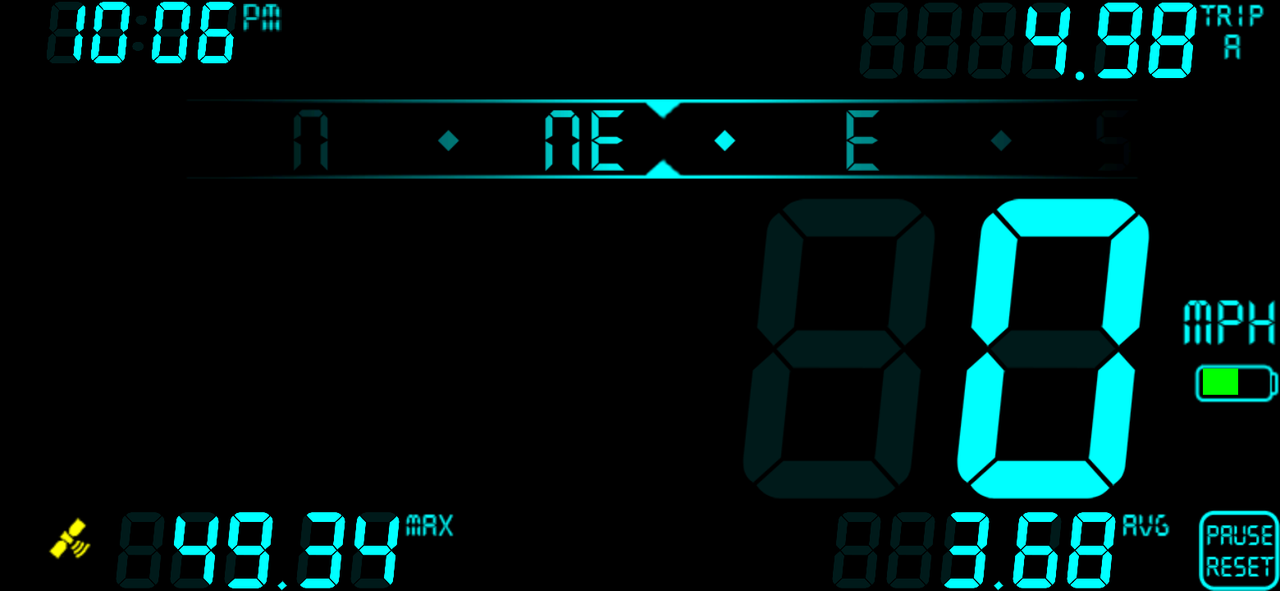

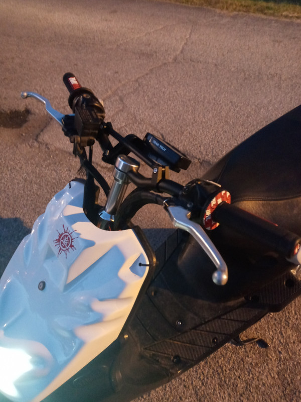

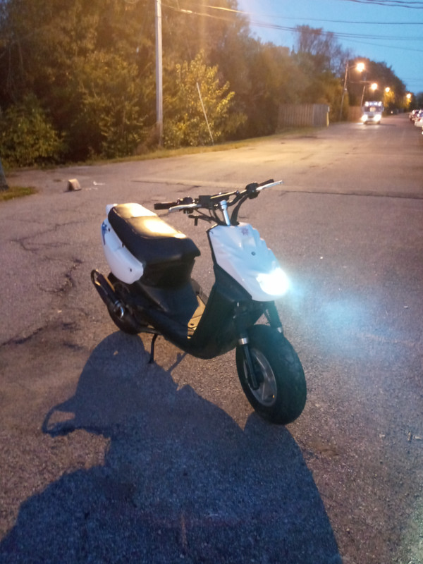

Post by CrankingWithCG on Oct 22, 2020 19:14:23 GMT -5

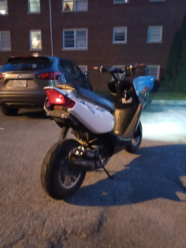

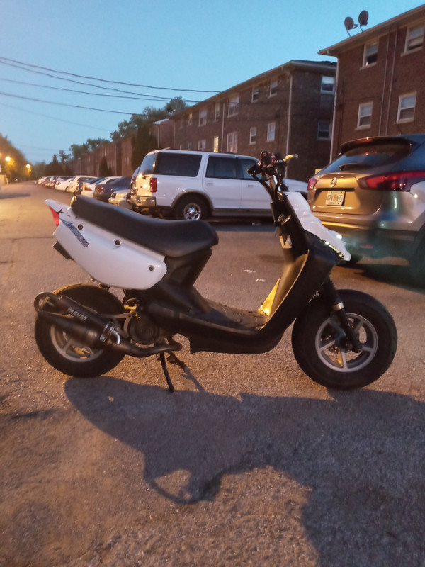

Top speed runs averaged about 48mph. Going down a very mild downhill, she was screaming to damn near 12k. But flat ground stuck right between 9 and 12. I have to be at 9k to do almost 40 and keep up with traffic. To do 30 i can be at around 8k. It takes off pretty quick still, stable at high speed mostly, though the cvt is scaring me. I put in the new polini rollers, tightened the variator back on, and theres a noise coming from the general area. Sounds like sticking paper in a fan. Im starting to worry about transmission bearings, or worse, crank bearings. But, she rides good. It bunny hops the wheel still, but im not gonna make a serious wheelie effort on it for a while. Bitch is scary. Anyway, here she is with her mean eyes on (though one isnt functional)and the new Tun'r bar setup!
