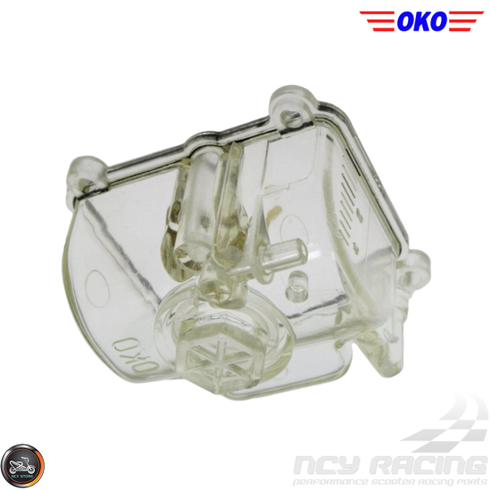

Well, I stand corrected. There are transparent float bowls available. I'm not sure it is a direct fit for the CVK carb for QMB139.
