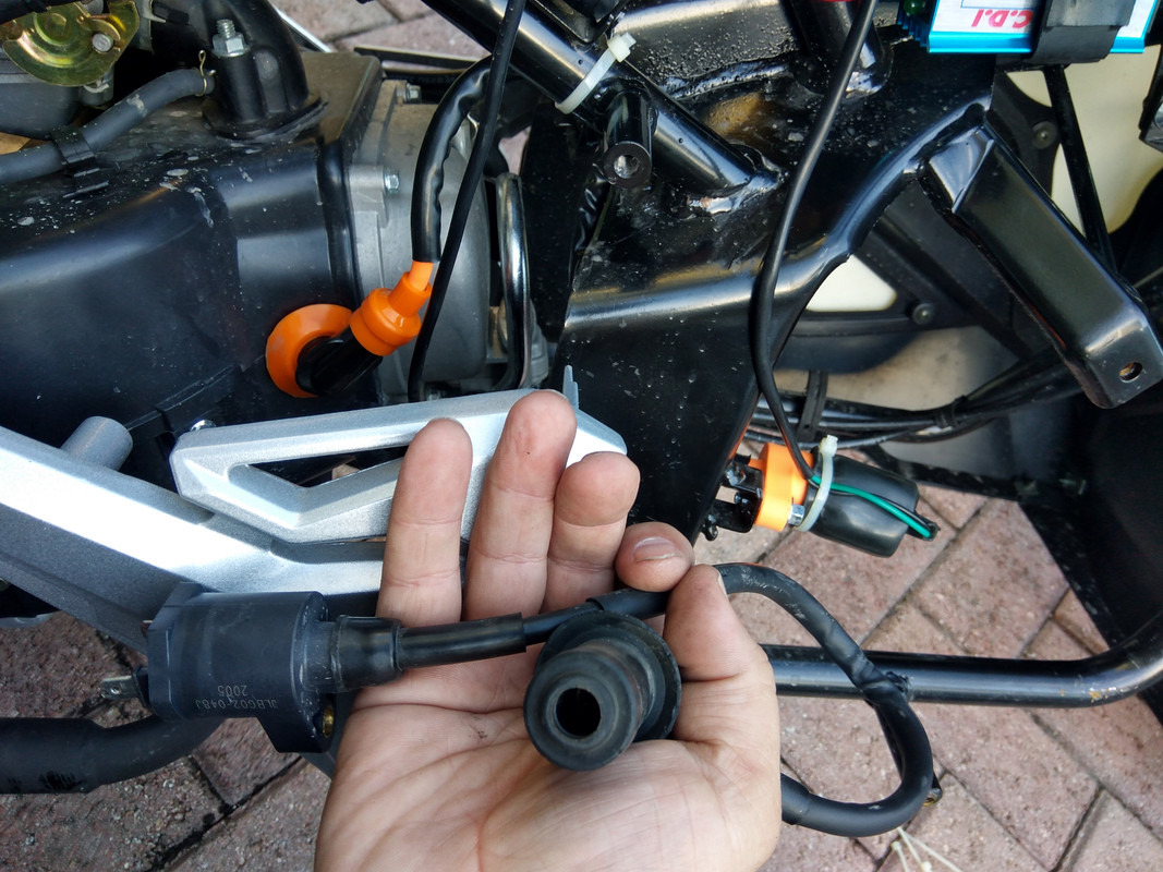

Post by elpres on Dec 31, 2020 19:01:54 GMT -5
Here is where the CDI and other end of the coil are located. Right side plastics off:

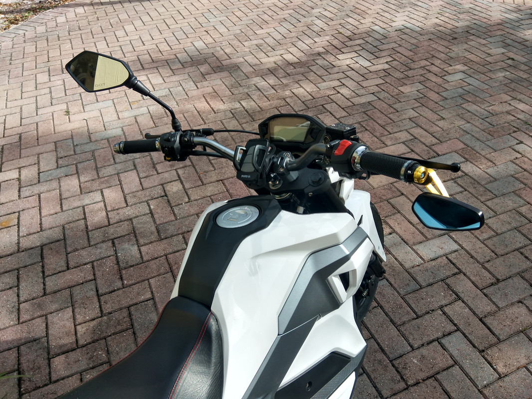

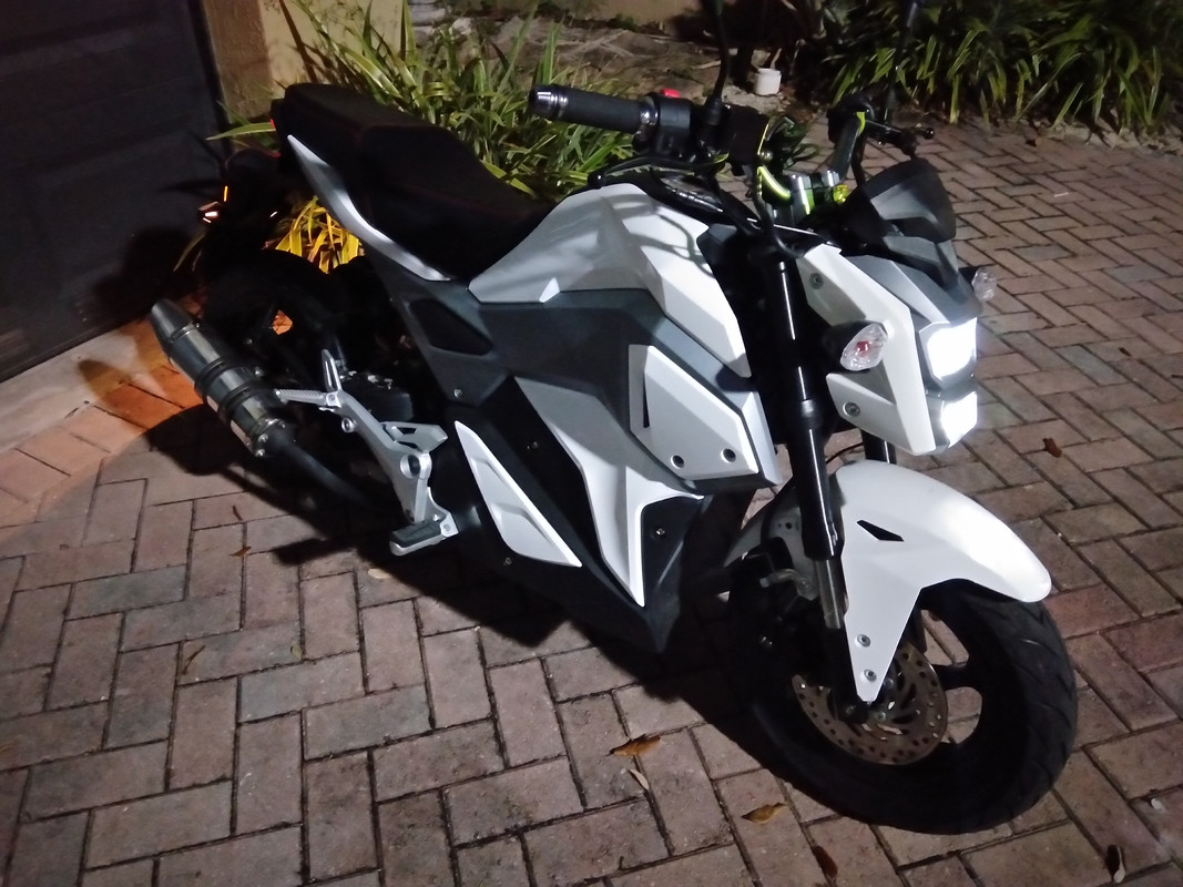

Post by elpres on Jan 3, 2021 18:06:46 GMT -5

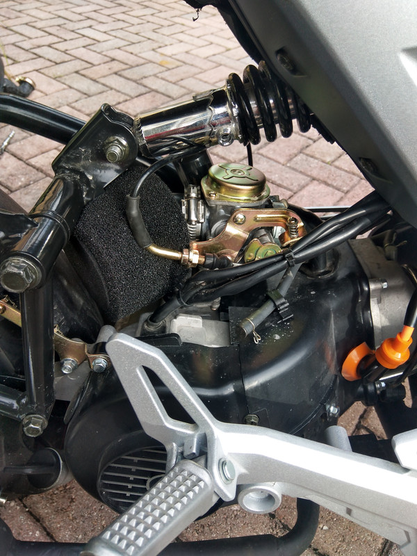

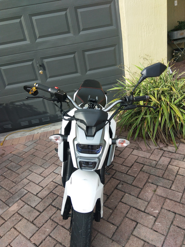

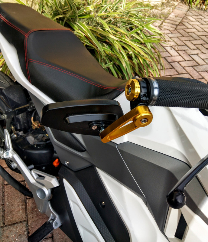

So my mirrors and foam intake came in. Of course I immediately installed them and messed around with the bars too haha. The factory Mickey Mouse ears are now off...forever.   Detail shot:  The intake was simple, two 10mm bolts and the hose clamp. Before:  After:  Detail shot:  The bike runs fine, I definitely need to re-jet it to work out the air/fuel curve.
elpres
Happy New Year everyone!
Posts: 22
Post by elpres on Jan 4, 2021 20:48:13 GMT -5
So today it had its first real outing since the intake being added and a little carb tuning. Its much peppier off the line, feels and sounds more torquey than before and on flat ground for up to 37mph but it could have gone higher it felt.

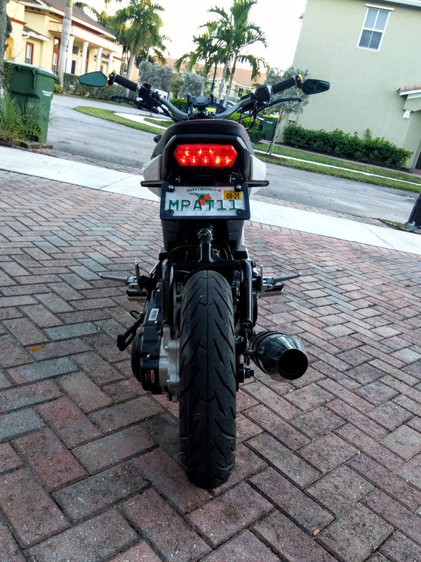

Post by elpres on Jan 9, 2021 18:07:31 GMT -5

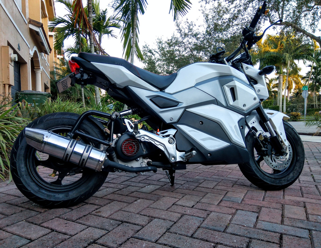

Rear fender delete came in along with new thin signals. Quality is decent ,but nothing to write home to Mom about. The installation was simple. Pop seat off, remove four 10mm bolts and it'll drop out the rear fender/lights/plate. The wiring still needs disconnected but it's simple unplug and replug. After that line the two side finishing pieces up and bolt them on with the supplied hardware. You might have to play around with the wires, but it appears that green on an Icebear is ground (normally black). Here's how it looks now:
Post by aeroxbud on Jan 9, 2021 18:23:47 GMT -5
No more riding in the rain. 😉
