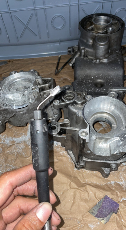

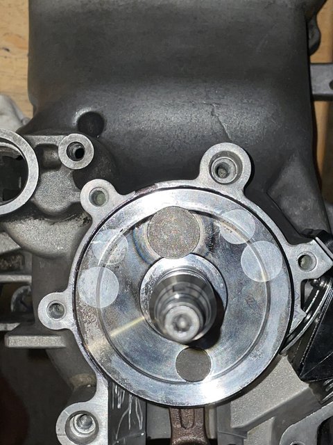

 The crankshaft can now rotate freely within both case halves. Ill cut the cases to match the cylinder skirts and ports sometime this coming week but I should definitely read up more on the process before I start. It was easier than I thought it would be to get the crank to fit in the cases but that’s more of a straightforward guided process compared to porting / trenching for me. I’m excited to get this cylinder fitted and I have to constantly remind myself to cool it on anticipating how fun it’ll be to finally get this thing started. Still a ways to go before then although!

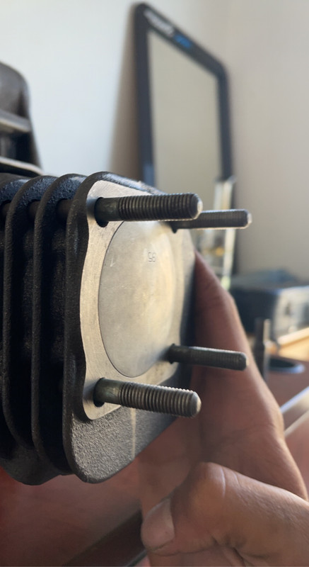

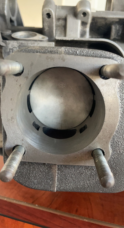

  After going at it for two separate 2 ish hour sessions I was able to slide the cylinder all the way down onto it’s base. I really enjoy using the rotary tool as I gain experience using it but with my current living situation I’ve been resorting to cutting in my bathroom and it’s been making the process tiresome and dreadful to say at the least. I have to clean up my mess real good after each session and my working position is just sitting cross legged on the concrete floor with the halves in my lap or in front of me. I would take my things downstairs to my complex’s parking lot and work there but since this is my first time doing this I know it’s going to take me a while and I just don’t want to irritate anyone down there while I take my time and figure out slowly what needs to be done. Also important to note that I really lucked out with this crank/ cylinder combo because this whole time I have been worried about the top of the piston sitting wayyy above the Ports at bdc meaning the cylinder base would need to be machines down or something and I don’t have the tools or money to do that lol. A 1mm thick base gasket did the trick to line things up better, the pictures above show how the piston sits at its highest and lowest points in the bore. Next on the to do list is trying to direct airflow into the ports and create a nice smooth path for air to travel along the way. I cant friggin wait to get this thing started up!! I also was wondering if anyone knows if it’s possible to buy any 5 pole stator armature coil and to rewire those connectors to my wiring harness hookup. I accidentally severed a winding or two on the old one when I was figuring out how to remove the flywheel lol. thank you for reading, I truly appreciate everyone on this wonderful forum and all the collective knowledge everyone brings to the table here. This is an awesome place that feels very welcoming to a newbie like me, especially when a lot of people in the scooter community here on Oahu, Hawaii seem to enjoy watching newcomers struggle and will misguide them, take advantage and in general don’t want to help in advancing their knowledge. at least just from my rather limited experience with these kinds of people.
Post by Zino on Oct 7, 2021 7:51:11 GMT -5
Looks good Plenty of us have had to build theses scoots up on our Kitchen Table or basement .
You have room to go with a little thicker base gasket to get bdc piston crown to be just before the exhaust port and dead even with the transfer ports .
This way you max out the port timing .
When you are all bolted up and check squish you may have to decide if you want maxxed out ports or better squish .

 Didn’t know that this was even possible haha oh well. The collets that came with this cheap rotary tool kit really suck it’s like they are made of plastic.
