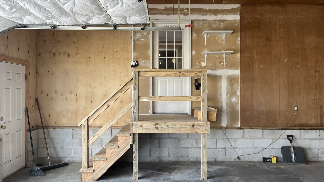

I got the sanding done and did some spackle and caulk. Not much. The spackle was mostly because the builders did a lousy job on the joints where there's drywall at the house entrance. I put quarter round on one drywall to lauan joint to sort of smooth out the transition from thick drywall to thin wood. I was going to do the same to the other side, but the builders did something strange again. The gap at the bottom of the drywall is 1/2", like the other side is all the way up and down. At the top it's near 1/2"... but a foot or so down it's not far off of flush. I probably should have shimmed the whole section out when the lauan went up, but 25 year old me didn't know or care to do that. At that time we just wanted the garage insulated with walls and didn't care about rough edges. Anyway, I just put caulk over there. No way I was ever gonna cut a piece of quarter round with just the right taper for that. The right way would be to straighten out the situation behind the wallboards, but I'm not interested in pulling down the walls and re-doing things. Fun fact; the entire wall on the house side was actually drywalled by the builders. We never asked for it to be done. They realized it wasn't in the plan/estimate and cut everything off other than where it meets the house and trashed it without ever talking to us about possibly leaving it all up. They left one section only because they said it needed drywall to meet code where it meets the house.
I added one support in the center to my little shoe rack add-on to the landing of the steps. I made that years ago. We used to trip over shoes entering the house or knock them off of the landing. Now they can fit in the add-on out of the way of the door and we put bags to hold recycling on top. Ugly, but functional. Once the sanding was finished, I spent a long time trying to get rid of most of the dust. The area that I'm not working on now is still dusty and everything will have to be cleaned when the project is about over. I finished one coat of primer on the ceiling earlier today. That actually took me about 10-12 hours over 2 days. I got 2 coats with a brush on the top edges all around first, so at least that's done. Hopefully the 2nd roller coat will go faster. I still have to do a 2nd coat around lights and brackets and such as well. I'm very slow with anything involving the ladder because I do not like ladders. Even with spending a bunch of time up there on garage projects with a good ladder, I'm still not comfortable so I'm not rushing when a ladder is involved. The only bad thing about the white ceiling is that it makes the edges of the lauan that don't meet up well obvious. The ceiling was done by a professional contractor so at least those aren't my fault. I think it was also screwy stud spacing that the original builders did faulted with making it tough to get everything perfect.

Construction standards for finish are a LOT lower in a garage. Use a baseboard to trim out large gaps at the base of a wall and wide trim at the ceiling. I often use a 1x4 for trim in a garage. Codes vary but the garage to house wall around here must have 5/8" sheetrock for fire protection. 1/2" sheetrock is required under paneling on house interiors for fire codes here. Fire codes are very important. Inspecting or rebuilding a house after a fire can be very educational and deeply chilling.

I ordered some diamond plate style rubber mat like I used on the workbench to make a mat for the landing of the stairs after they're painted. I'd like to secure it a little, but I want to be able to remove it.
I thought about putting threaded inserts into the landing and then it would be easy to bolt down without damaging the wood with regular screws going in and out... but I'd like no tools required remove/install.
I searched for floor mat grommets/clips/fasteners, but I see automotive stuff that isn't made to secure to wood and generally doesn't look like it would work quite right.
As of now, I'm thinking I could make some sort of stubby pins on the lathe that I could screw down to the landing. Kind of a mild T or mushroom shape. Then punch holes in the rubber mat to correspond and install rubber grommets. Not sure that rubber grommets would be needed, but may prevent wearing the holes or tearing the mat. Should push on with enough effort that it's secure, but be easy to remove/install.
If anyone has a better idea that is less work than making custom pins and all of that, please lemme know.
Post by FrankenMech on Feb 5, 2023 10:57:22 GMT -5
I don't know anything about better but fender washers, pan or truss head screws, and T-nuts would probably be OK. Stainless steel hardware would probably work best. Aluminum "L" channel for the mat to slip under may help secure the stair side to prevent tripping. I think they make some stair tread nosing type product for that application. Check with Google and the home box or hardware stores.

Keep it simple, screws and fender washers, they work and will make removal easy, 2 mins with a screw gun and it's off.
Use enough with good spacing and ripping should not be a problem

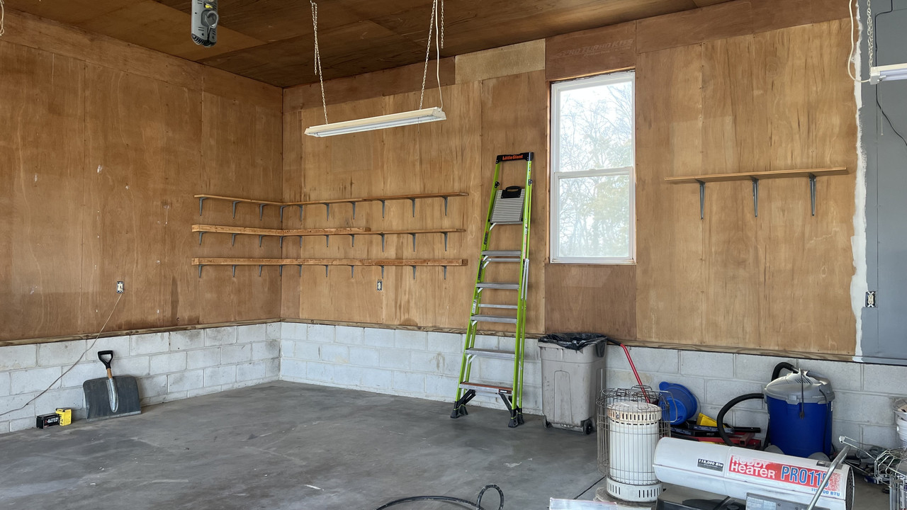

I finally got all of the coats of primer and paint done on the ceiling. Now both hands are numb from carpal tunnel due to so much time pushing a roller on a stick into the ceiling and holding a paint brush. I got some new cords and rubber cushioned clamps to try to improve the ceiling wires a bit. One bay done so far. Replaced an old fluorescent light that has a bad switch with an LED light while I was at it.

Looking good đź‘Ť

Not as much progress as I’d like, but a bit of priming. Trying to work in shorter intervals to help the numb/sore hands heal… or at least not get worse. I came home yesterday to a cracked window in the house. My parents said there was a loud pop or bang and they thought something big had fallen over, but nothing had. 30+ year old original window, just like all of the others in the house. Luckily it just cracked the inside pane and the outside is OK so it’s not an emergency. More crap to fix.

The white paint is looking good. The white will make a lot of difference in the light. It may have been some slow compression that broke the window. Maybe some house settling that twisted the window. Get some silicone sealer on those cracks to keep water vapor out of there as much as possible. Otherwise water/fog/ice/frost will fill up the window. The auto parts stores sell a type of thin penetrating silicone sealer for windshields. www.autozone.com/sealants-glues-adhesives-and-tape/windshield-repair-kit/p/permatex-windshield-glass-sealant-1-5oz/552992_0_0I think that whole dual pane unit must be replaced. Check your foundation.
