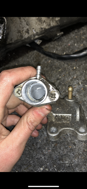

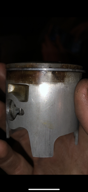

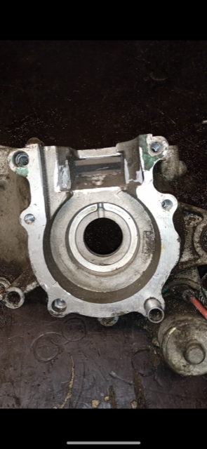

I need ideas for my build, current setup: Airsal 70 Dellorto 21 I had a friend port my casings etc: smoothed block (grinded for airsal, for better flow etc Pro replica Stock clutch with +2000rpm clutch springs 6,2g rollers and +22 contra better flow in reed valve (sorry for bad english) Malossi multivar ported stock intake manifold (22mm) What could i do to enhance speed. Also you can see my 500km droven piston ![:D](//storage.proboards.com/forum/images/smiley/grin.png) , my head was leaking but not anymore, i bought new piston ring. ![](https://i.postimg.cc/8z4mLmc2/unnamed-2.png) ![](https://i.postimg.cc/qMXsdxsN/image6.jpg) ![](https://i.postimg.cc/2Sk4jLG2/image7.jpg) ![](https://i.postimg.cc/rmr4Z1yF/unnamed.png) ![](https://i.postimg.cc/N0LmmhWX/unnamed-1.png) ![](https://i.postimg.cc/VNTMFG8V/unnamed-3.png) ![](https://i.postimg.cc/t4BFsRmy/unnamed-4.png) ![](https://i.postimg.cc/4yR9DYnv/unnamed-5.png)

did your friend remove the support leg when he "ported" the intake track on the engine block? from the picture, it looks like he removed it. i have read that removing the support can lead to problems, there is a reason it was cast there in the first place. it is a good place for a leak to develop when the engine heats up.

That case "porting" needs at least two hours with a rotary sander. ![](https://files.catbox.moe/p846y6.jpg) You really should only case port when everything else is maxed. More flow isnt always a good thing.

are you running the air shroud on your engine? i can see the fan in your picture, but i also see the cooling fins on the bore and head too. did your friend remove the support leg when he "ported" the intake track on the engine block? from the picture, it looks like he removed it. i have read that removing the support can lead to problems, there is a reason it was cast there in the first place. it is a good place for a leak to develop when the engine heats up. that engine you have there, if only you knew it's real potential. what you have there is "gold" for us in hawaii in the scooter/moped realm. there are many guys here running the streets with fast engines like the one you have. so many different set ups for that engine, stock stroke, mini stroker, and stroker kits in excess of 120cc. i will tell you this much, none of the fast guys use a stock intake manifold. most of the fast guys run 24mm - 28mm pwk (OKO, Polini, Stage 6)carburetors too. how fast do you really want to go? no tags/plates and no brake lights or turn signals? seems very sketchy to me. Yes i am running it. Im not sure if it's for "support" since its just in front of one reed. Im looking forward to buying 24pwk and s6 intake manifold full set with the reed cage. You were talking about the potential of my engine, I didnt know, i just thought it's one of the worst since the lack of parts and lack of "high" end cylinders etc.
