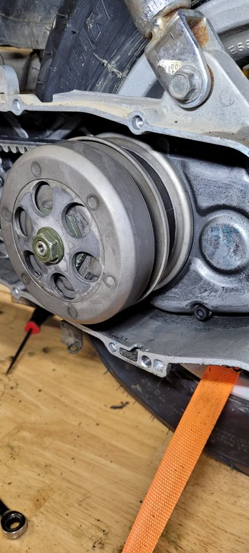

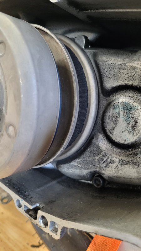

Finally feel like I am getting somewhere now. Threw the oem belt back on there, and it looks much better than the polini belt did, so I'll be running with that one till I can get another oem ordered. Pic of oem belt vs polini belt rear pulley height below: ![](https://i.postimg.cc/g01LHcWM/20220509-130650.jpg) ![](https://i.postimg.cc/1Rr4frf7/Screenshot-20220509-130718-Gallery.jpg) Wanted to be able to leak check the system including the exhaust flange seal, so ended up making a makeshift plug for the end of the exhaust pipe, since the polini speed exhaust is solid/no separate silencer tube like the expansion pipes. Seemed to work fine, and held 5psi just like before. The intake side of the leak ckeck system is just a test pressure gauge ($11 at lowes) and a pvc elbow (under $1). The test pressure gauge has a schrader valve to add air. I have a air compressor tank gauge that I regulate down to 10psi, then an additional inline pressure gauge that I turn down even more, which allows air pressure to slowly increase. This is definately needed for this setup, otherwise you would be blowing out seals, etc. ![](https://i.postimg.cc/DfRgCF2b/20220508-110212.jpg) Anyways, installed the 100 main jet out of the stage6 6mm jet kit, at WOT it sputterred very bad, almost felt like hitting redline but way too early. Put on the 95, ran a bit better, but still some sputterring. Put on the 90, and it is starting to feel alright now. Checked the plug, it is still pretty dark, but this is as far as I want to go before I have a cht gauge, one is on the way.

Still looks like you might need to shim the variator. My stock belt rides flush with the rear pulley on my 05 with malossi multivar.
Post by girldad93 on May 14, 2022 19:02:57 GMT -5
Yeah, definately looks like the belt should still be riding higher in the rear pulley. How do you go about shimming the variator if the variator nut is basically flush with the end of the shaft? Does the starter gear have to be removed to add room for shims between the variator halves?
Post by bigmatthew86 on May 15, 2022 7:26:37 GMT -5
As long as you don’t get crazy you can still shim a little. I just bought a pack of different thicknesses & went at it.
