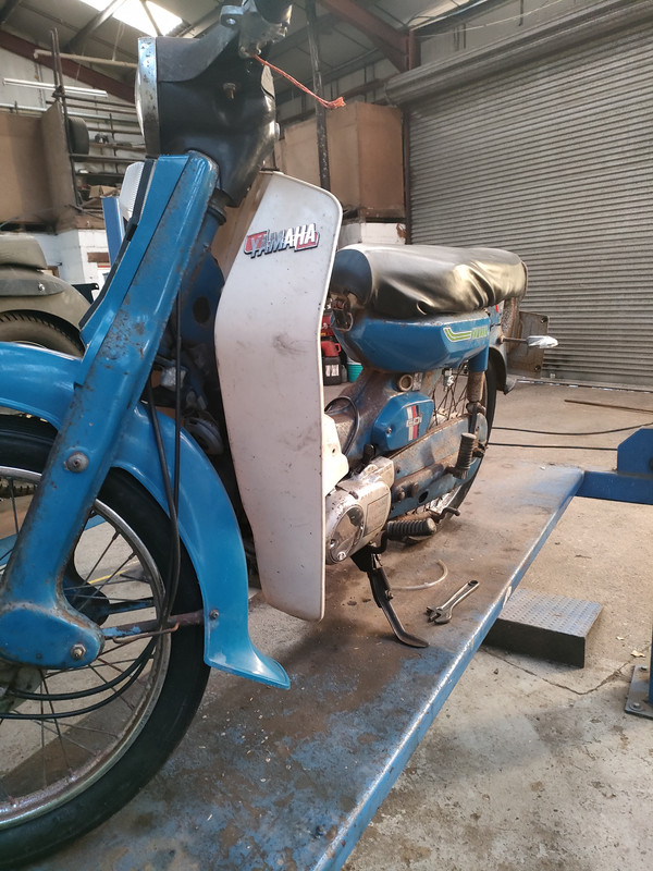

Post by milly on Jun 10, 2022 4:22:32 GMT -5
Last night I put the case on and off 3 times even once with oil because I know it all. Today I am going to read the manual once removed all the pinions so I can get to the Kickstarter and put it in properly so it works.

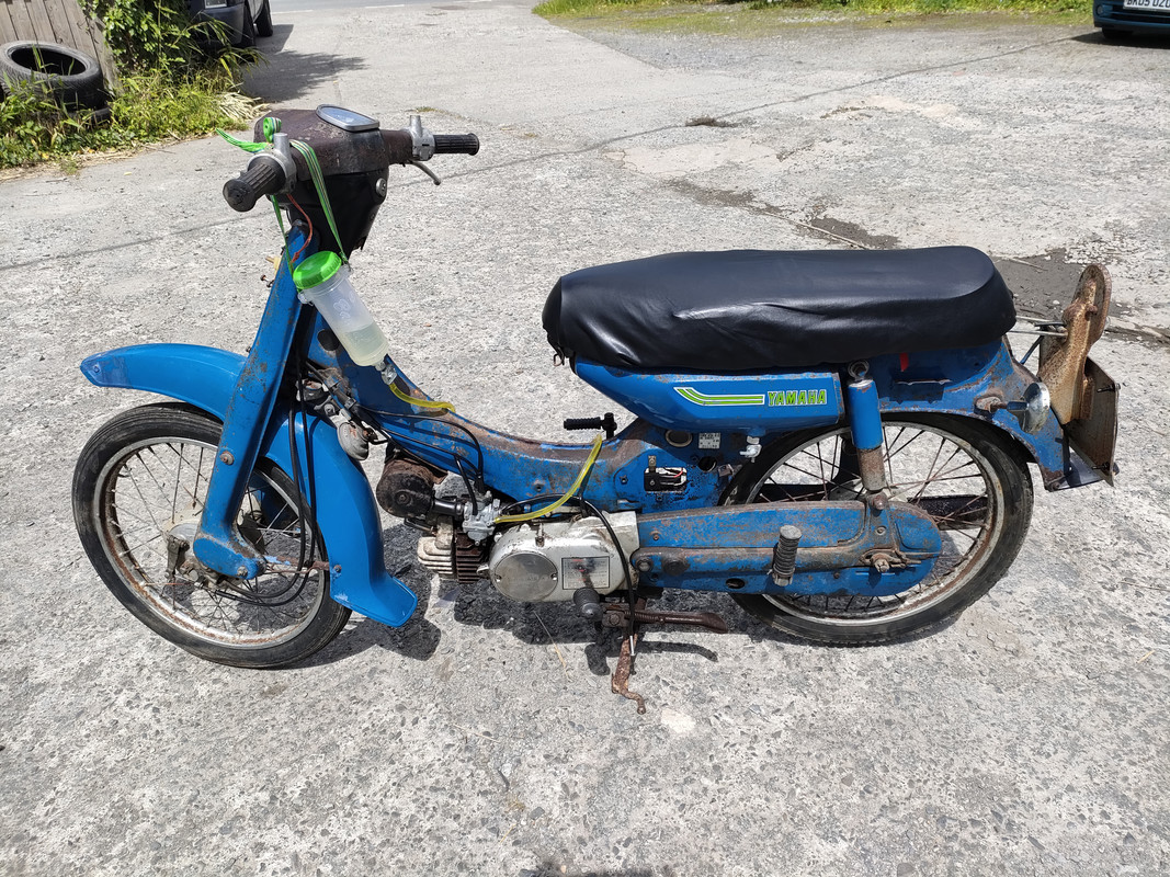

Post by milly on Jun 10, 2022 15:35:41 GMT -5
Well after two attempts today the casing is on and the Kickstarter works. Engine running on choke only at present but not a problem once the 2 stroke smoke has cleared tomorrow in the garage. Looking clearer now in the pic.
Post by jackrides on Jun 11, 2022 12:28:51 GMT -5
Sometimes acient gas will form a plaque around the main jet holder/emulsion tube. Easy to remove, just don't ding the threads for the main jet. No, I will not tell you how I know.
Post by milly on Jun 12, 2022 8:04:08 GMT -5
Cleaned the gum out the carb and took it for a few hundred yards spin all good it revs now but stays high so bit more fettling to do, then the tank lights etc. Wish I had remembered the brakes needed adjustment while riding it. 😊

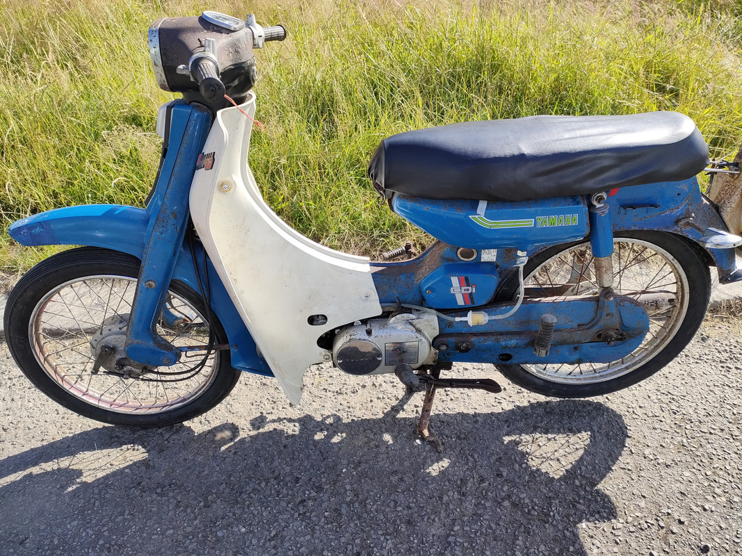

Post by milly on Jul 8, 2022 16:04:26 GMT -5

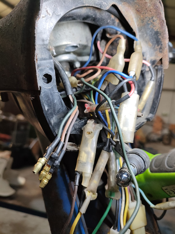

Managed to check out the fuel tank today and surprised it was clean and shiny. Added petrol and no leaks so put the wiring back together and battery in may get round to doing bit more tomorrow.
Post by milly on Jul 9, 2022 8:23:32 GMT -5
All working well today been for a road test the two gears change ok and hi and low ratios work well. Just awaiting the bulbs to see if lights are working and adjust front brake a bit more.
Post by milly on Jul 9, 2022 15:28:17 GMT -5
Bit more done today, front brake and drained the tank but hardly any bits in the petrol.
Post by milly on Jul 14, 2022 11:57:49 GMT -5
Up and running properly, road test done. Handling is horrible no damping on front suspension on these models. Not for me I think it can go.
