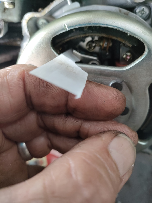

Post by milly on Jun 5, 2022 7:44:12 GMT -5
Not done that for a long time, ignition timing with a cigarette paper. Still works spot on.

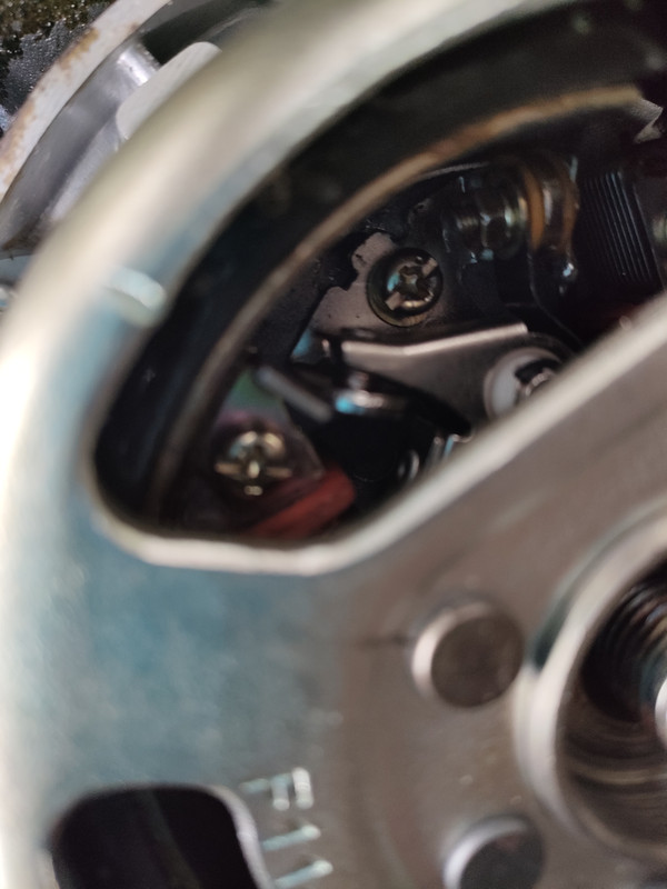

Post by milly on Jun 6, 2022 12:50:21 GMT -5
Ignition side sorted.
