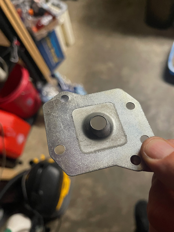

I've done the internet searching and was able to take all of the restrictors out including: snipping the rev limiter wire on the ECU, removing the washer in the variator, and pulling out the intake restrictor plate. After doing that it wouldn't rev at all without leaning out so I ordered some main jets and did a LOT of trial and error and settled on a richer main jet. I went richer and richer until it really wouldn't clear out then jetted down so I knew I was on the edge of rich versus on the edge of being too lean. This bumped the top speed to 35 mph on the level with no wind.
