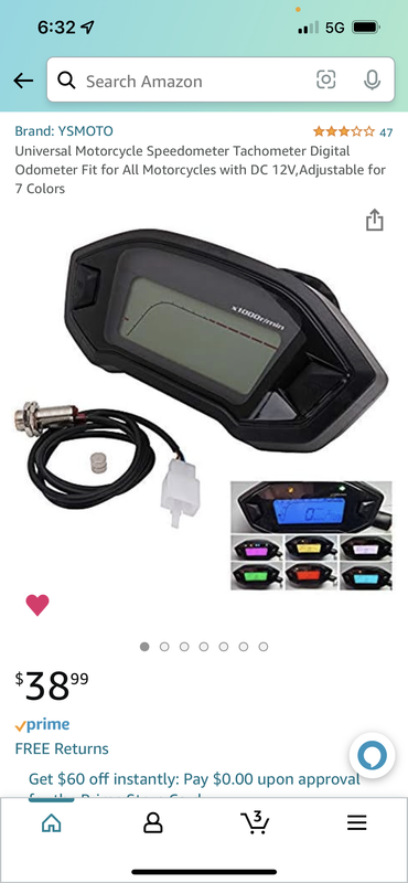

Post by captincvmn on Oct 18, 2022 5:34:27 GMT -5
 i bought this one and morphed it to look like it belonged on my China Scoot dash board. It works well except for the damn clock, time won’t change. I have 3500 miles on it now.

Post by Petro on Oct 18, 2022 16:33:01 GMT -5
 i bought this one and morphed it to look like it belonged on my China Scoot dash board. It works well except for the damn clock, time won’t change. I have 3500 miles on it now. I bought two of them, one didn't the clock stay in memory and the other one didn't work at all... I wouldn't recommend them at all, not even mention them... Which I already did... 8/
