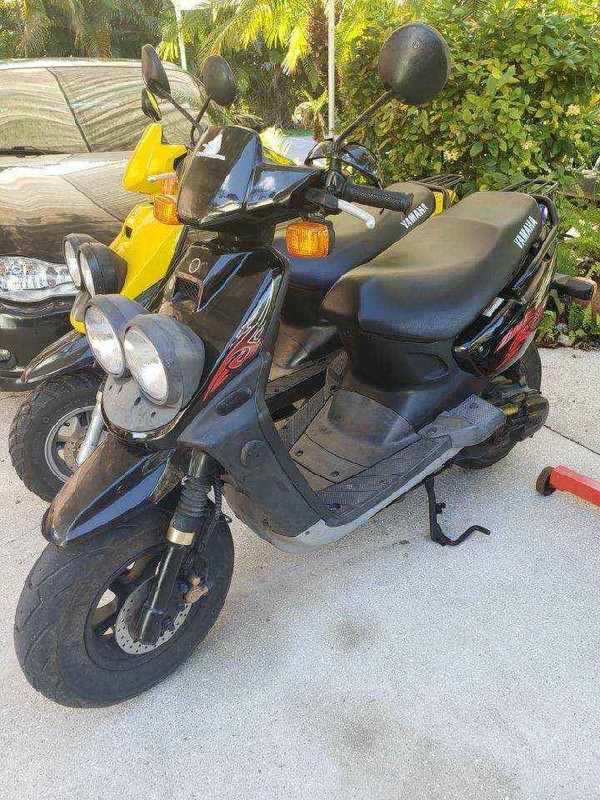

Thanks for the Information. I have found a 2009 50cc Zuma not far away. Only 850 original miles. Says it runs great, been in storage. Any gaskets etc. to be concerned about if its been sitting long? Thanks
Post by aeroxbud on Jul 17, 2022 16:10:10 GMT -5
I would probably go through and change the oil and fuel lines, and tires. New fuel and battery. Nothing that you wouldn't do when you recommission a motorcycle that's been sitting for years. It will probably need a carb clean, and could have oil sitting in the cylinder if it's drained from gravity out of the tank. These are very simple machines to work on. There is a downloadable manual for this bike in the manuals tab on the left.
