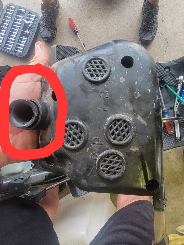

Post by ultramanmike on Aug 3, 2022 5:06:52 GMT -5
Throw the rubber knee in a bowl with boiling hot water. It will go on easier. Yeah thats what I did... it did help quite a bit. Currently running a 95 main jet, thinking I'll be @ a 90. I'm in Chicago super humid in the summer. I ordered a trail tech temp gauge should be arriving today. I've been reading to stay around 350 degrees. I also forgot to mention my stock airbox has 6 uni small little round filters... installed from previous owner.

Post by Zino on Aug 3, 2022 8:16:37 GMT -5
Those holes dont add anything but sound and alot of tuning variance . You are jetted way up to make up for those holes . I was at 80-82 for stock airbox with a Yasuni R Malossi 19mm Dellorto combo on my Zuma
Post by ultramanmike on Aug 3, 2022 10:02:03 GMT -5
Those holes dont add anything but sound and alot of tuning variance . You are jetted way up to make up for those holes . I was at 80-82 for stock airbox with a Yasuni R Malossi 19mm Dellorto combo on my Zuma Should they be plugged? We're you running a 70cc cylinder kit using the 80-82 jet? Should the little snorkle on the stock airbox be removed?
Post by ryan_ott on Aug 3, 2022 10:38:17 GMT -5
Get a replacement airbox or close up those holes. A stock box with the snorkel removed flows plenty with a clean OEM filter. Also helps to use smaller jets and keeps the noise down.
Post by ultramanmike on Aug 3, 2022 10:58:29 GMT -5
Get a replacement airbox or close up those holes. A stock box with the snorkel removed flows plenty with a clean OEM filter. Also helps to use smaller jets and keeps the noise down. Thank you, I'll plug the holes. What jets would you recommend with a 70cc sport kit? Thanks
Post by Zino on Aug 3, 2022 17:18:08 GMT -5
Low to mid 80s is a range I would look at with stock air box snorkle out with a 19mm Dellorto Low 80's with snorkle in
