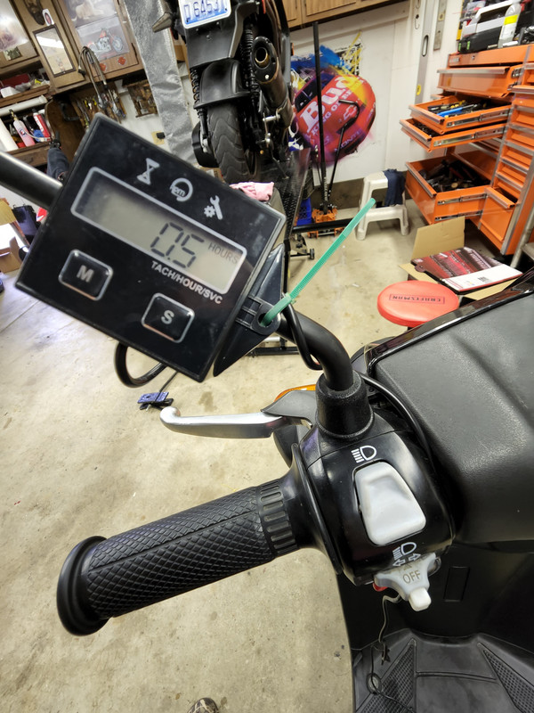

Hello everyone! I'd love to see everyone's tach & temp mounting positions are on a Zuma 50cc . I have a good idea where I'm mounting the trail tech but not so sure about the tiny tach. What tach does everyone use... I want something super small! Thanks in advance Mike

I put the trail tech temp gauge here... it covers the oil light but I'm running premix.
Post by Zino on Aug 7, 2022 14:20:48 GMT -5
Looks good there I mounted mine with double sided tape just below brake fluid reservoir

Looks good there I mounted mine with double sided tape just below brake fluid reservoir Thanks ! Do you keep a tach on your scoot all the time or only when testing 🤔
Post by Zino on Aug 7, 2022 17:52:29 GMT -5
I just mount a tach up for tuning the cvt and Carbs I buy the cheap amazon ones that takes watch batteries.
