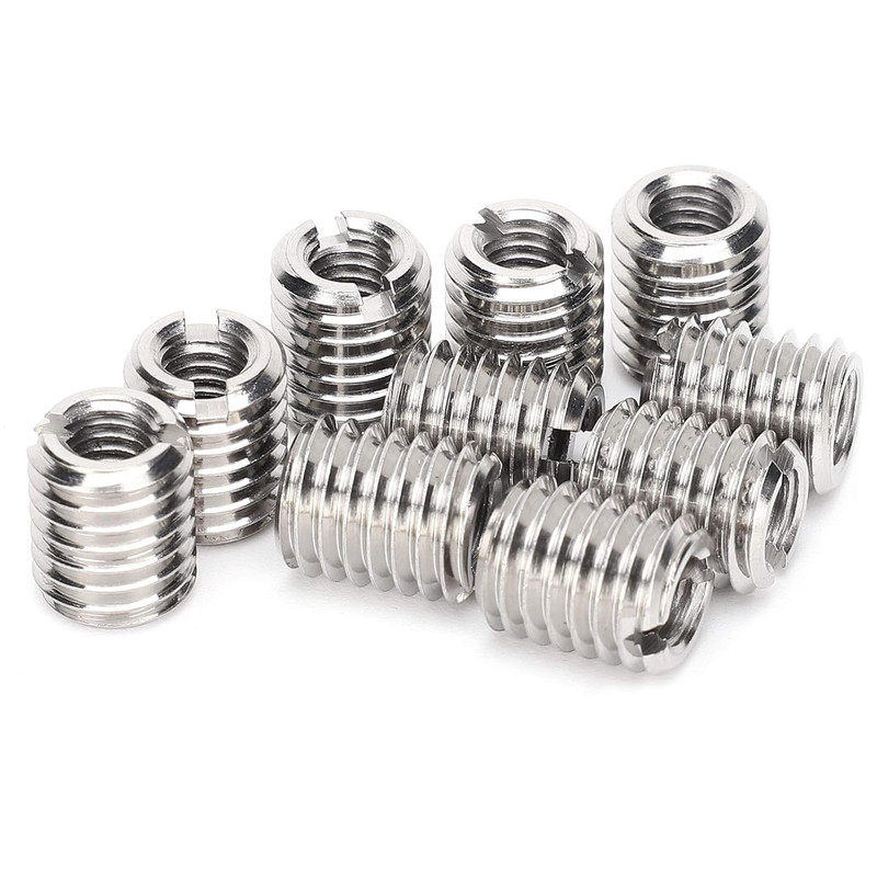

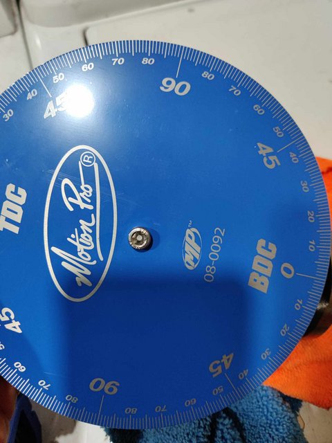

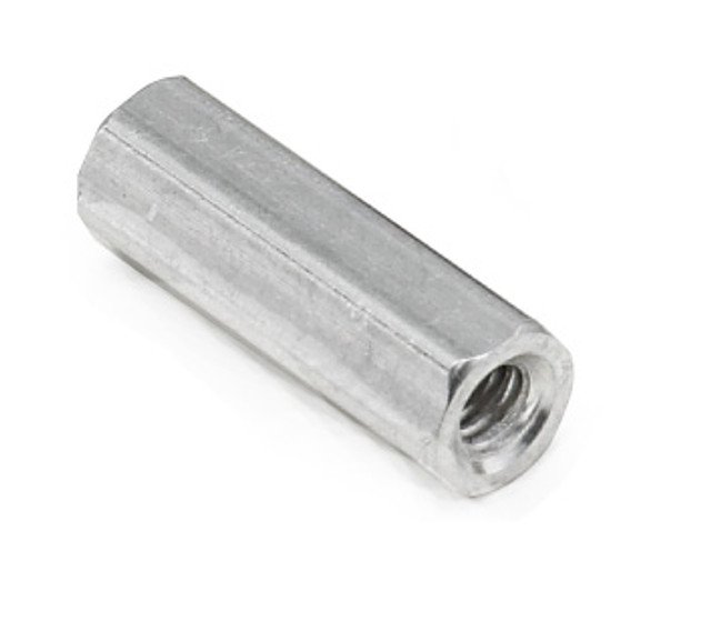

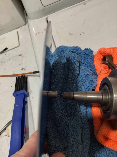

I've been looking into measuring port timing and received a motion pro degree wheel for christmas. It is drilled for m6 in the center. I would like to mount in on the end of the crank of my Honda af16 engine which is m10x1.25. I thought I had a pretty good solution figured out. I found these on amazon... www.amazon.com/dp/B0C4VBD2GJ?psc=1&ref=ppx_yo2ov_dt_b_product_detailsBasically I would use an m6 bolt to thread into the adapter and then use an m10x1.25 coupling nut to adapt to the crankshaft. Well, unfortunately the adapters I received are actually m6x1.0 female to m10x1.5 male. I believe the listing is just wrong, rather than that I just received the wrong item. I cannot find any source of m6 to m10x1.25 adapters. Does anyone else have any other ideas on how to mount this degree wheel to my crankshaft? I'd rather not try and drill it out any larger.

It would be easier with a lathe, but you can make your own adapter with drilling and tapping.
Get a piece of round bar. I'd use aluminum for easier working and it doesn't need to have a lot of torque applied to it anyway for this job.
Cut it as square as you can on both ends. Sand, file... whatever to get it straight. McMaster-Carr has 3" pieces of 1" 6061 for ~$5.50 as an alternative example, but you'd have to pay shipping.
Drill and tap one end to M10x1.25 and the other to M6x1.0.
You can grind flat spots opposite each other on the rod if desired to be able to get a wrench on it or start with hex bar.

I would just use a step bit and drill out the degree wheel.

I would just use a step bit and drill out the degree wheel. That was my first thought as well, but if it needs to be spaced out the adapter could work as the spacer.... I guess so could a coupling nut if it's long enough. It could be good to preserve the smaller hole if the wheel were used in other applications... but for scoots it's unlikely that you'll be putting it on a crankshaft smaller than 10mm. I use custom spacers to remove slop in the mounting if the center hole is too big, but then you may actually need a lathe for those.

If you don't want to mess up the center hole, then just make a backing plate for the crank shaft, and bolt the degree wheel to it. 4 small bolts to the backing plate and keep the center hole. No machine necessary except drill and tap back plate for crank and attach the wheel to the back plate via a couple small bolts. Piece of flat steel and a angle grinder cut off disc , cut to shape, drill and tap for crank and attach wheel with small bolt pattern and you are good to go
